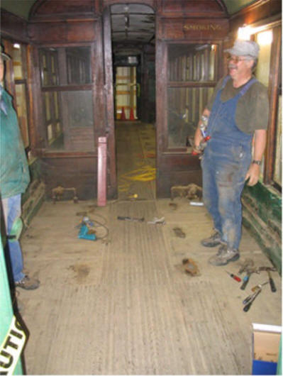

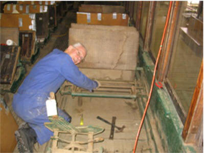

After the heater wiring conduits were removed, the lower interior side panels and molding were detached. Because of a large structural north-south piece the paneling under the windows is met with a molding and goes inward 90 degrees where another panel segment continues to the floor. There is a joint/crack where they all meet and over the years passengers have lost items like coins, some of which slipped between the cracks.
The oldest coin volunteers found was a Queen Victoria penny lost, perhaps, by a young Canadian heading for the trenches of WWI. Other coins found were both Canadian and American: A testament to the joint ownership. Transfers and "fare paid" slips of paper were also found.

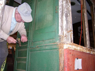

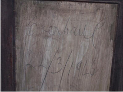

Another interesting item was found when retired BCER motorman Frank Horne was removing a portion of one of the bulkheads. On a piece of plywood, that appears to have replaced some glass, was the date 22/3/1946. Another fragment of the car's past history. Early inspection had shown that, for the most part, the window frames in 1225 are in sad shape, the years in the dry California sun having taken their toll. The window frames will be replaced with original mahogany and all the windows will be updated with safety approved glass.

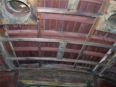

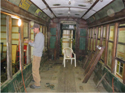

However, one of the most pleasant surprises was found when all the interior ceiling panels were removed. The roof supports and the wooden roof strips appear to be in excellent condition. Thus, the roof will remain as is, with only slight repairs and later will be recovered with a new exterior canvas and waterproofing.

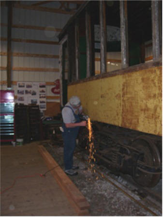

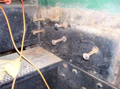

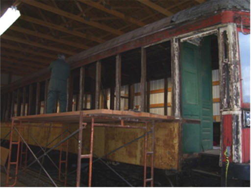

In order to assess the condition of the wood frame that the steel side plates are attached to, the plates must be removed. The steel side plates are also attached to the window uprights/roof support and these all need to be replaced with oak, matching the originals. Plate removal is a challenging job as not only are the plates held on with carriage bolts and rivets but also hundreds of slot screws.
Numerous methods are being used to remove the screws: by hand, by a pressure punch or by drilling off the head. Once again the volunteers attack the job with enthusiasm. It is hoped the side plates will all be removed by the middle of January, 2006.
