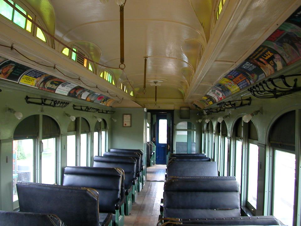

As the Illinois Railway Museum's (IRM) effort to restore Chicago Aurora & Elgin car 308 starts to wind down, we take a look back at the past year of work on this 1906 wooden interurban coach. The end of 2004 found two major projects the focus of work on the 308. The first, and larger, was rebuilding the ceiling. During the years it spent outside in the 1960s and early 1970s, the car's ceiling veneer had badly deteriorated in spots. Between 2002 and 2004 project worker Jack Biesterfeld had stripped and repainted the center section of the car's Empire ceiling, where the veneer was largely in good shape, but the more deteriorated hip sections remained to be done. Project Manager Randy Hicks spent much of the winter of 2004-2005 replacing rotted veneer, as well as replacing the plywood panels beneath it where necessary. By the spring of 2005, work on the car's ceiling was essentially complete and the entire ceiling was painted in ivory.

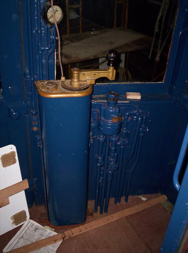

The second major project was the installation of a C-21 controller in the car. Built with C-21s, the car had been retrofitted with C-6 controllers during the mid-1950s. As part of the museum's backdating effort, two C-21s were procured, rebuilt and reinstalled. The second of these was put in the car in January 2005, making the car not only electrically complete, but electrically authentic.

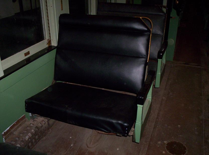

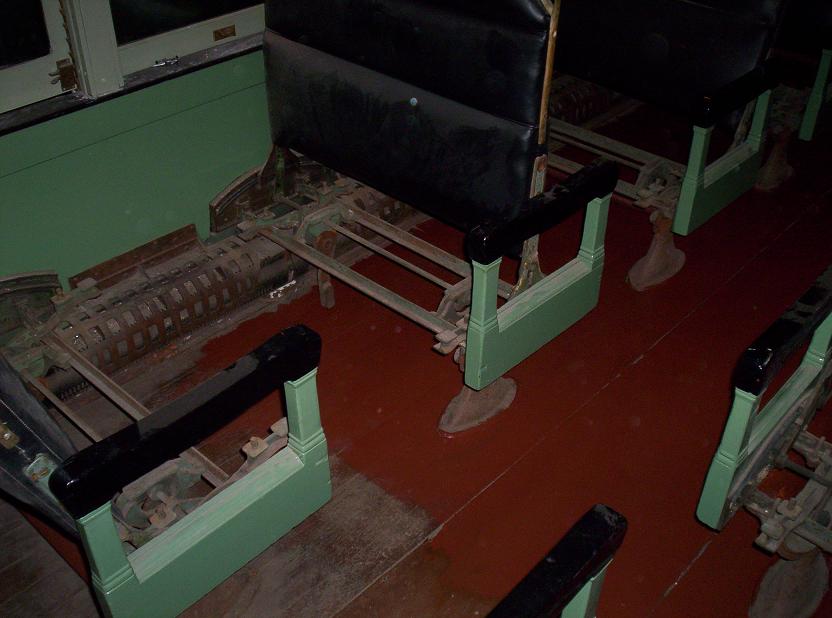

So, since the only way the interior could be authentically painted was in its 1949 colors, we decided to change the target date of the car's restoration from 1939 to 1949. This involved repainting the exterior of the car, painting over the "SUNSET LINES" emblems, and discarding other work that had already been begun to backdate the car to 1939. Fortunately no major changes needed to be undone, but it was still aggravating to take this step. It was generally acknowledged, however, that in the name of historical authenticity, it had to be done. The decision to change the target date was made in early 2006, and meanwhile work continued in the spring. Several seat backs were professionally reupholstered in black leatherette, and the painting of the smoking compartment interior (which had been stripped prior to acquisition of the car by IRM) was completed. Work was also begun on construction of a new wooden third rail beam, as one of the car's originals had been found to be slightly rotted.

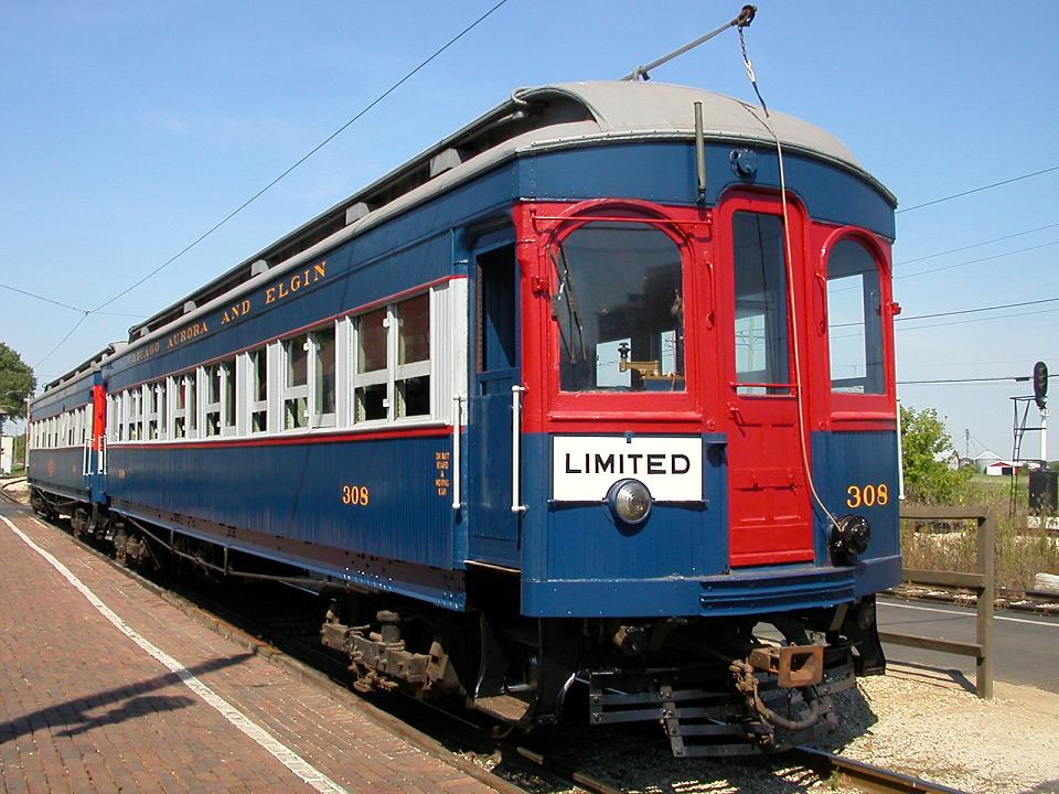

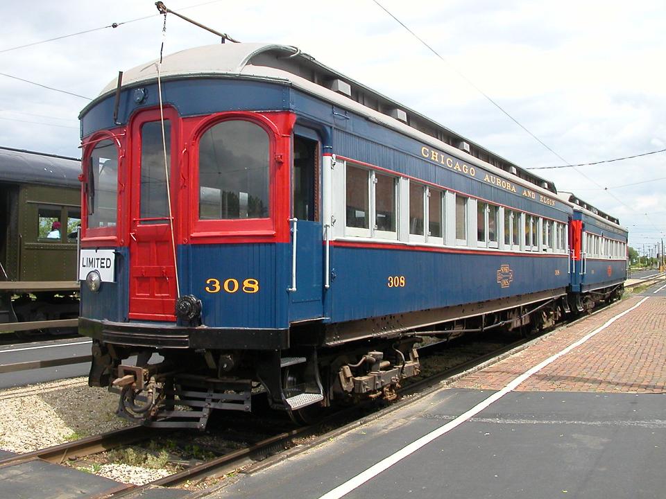

During May, the car went through its annual inspection and the usual list of minor repairs and adjustments was attended to. Since 2003, car 308 has been in regular service at IRM along with similar car 309, and this limits the amount of work that can be done between Memorial Day and mid-September. Even so, though the car was operating about every other weekend during most of this time, improvements continued. Window repainting continued steadily, as did replacement of various trim pieces in the car's "new" vestibule (308 was acquired by IRM with one vestibule missing, the victim of an unfinished restoration). During August the 308 and 309 were not scheduled to run, so we took this opportunity to "forward-date" car 308 from the 1939 livery it had worn since 2002 to the 1949 livery we had now found to be accurate. The obvious changes included blue side sills and anti-climbers, no "SUNSET LINES" emblems, and small legends next to the doors admonishing people not to board moving cars. By Labor Day, when 308 and 309 were back in service hauling people on IRM's line, the car looked as it did in 1949 inside and out. Since the operating season ended in September, more work has gone into car 308. Both retrievers were disassembled and rebuilt, as one had failed and the other wasn't taking up the trolley rope properly. Several more seats were reupholstered, the last rotted sections of wall veneer were patched and painted, and most of the car's floor was painted brown. Air brake work is being done on the car, including rebuilding control pipe gladhands and lapping angle cocks. Work on refurbishing the last of the car's doors and windows is also being completed during the winter.
