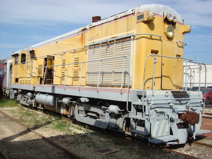

I have heard stories about these flame incidents myself but have never had the experience of seeing one in person. On average how would you describe the routine maintenance of an FM reportedly I'd been warned pursuing the project solely for this reason. Reports from former MLW staff who I've been able to speak with complained of their complexity and unfamiliarity to anything they'd worked on previously. Honestly never touching an engine in my life would it be something easy to get used to or more of a struggle in your opinion? Otherwise I look forward to new progress in 2016 and hopefully we'll get some goals off the ground,
Cameron
