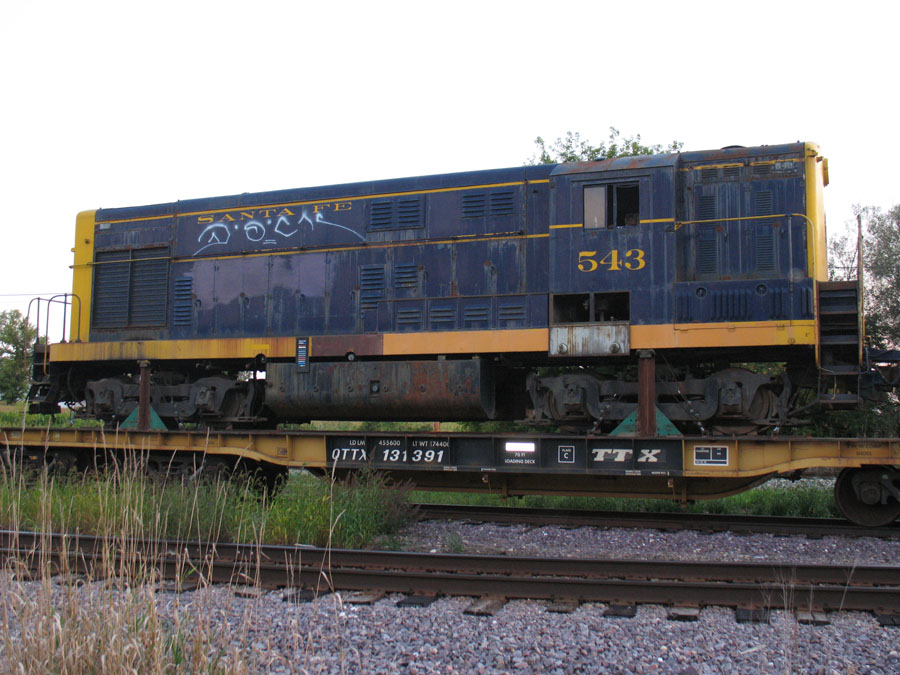

I got a C- grade in freight car identification in college, so need some help here.
What is this flat car? I've never seen one like it, but it's obviously designed for heavy moves. Are they common?
http://en.wikipedia.org/wiki/File:WCR_6593_Alco_S-3.jpg
 Post subject: Re: What kind of flat car is this?
PostPosted: Sun Jun 09, 2013 4:47 pm
Posts: 473
Standard issue 8 axle heavy duty flat. TTX, Kasgro and probably others own/lease them out. The ones we move on a semi regular basis have dual brake systems -- one for each end of the car. Depending on the car the trucks are either F or G bearings (some of the newer ones are K bearing). You have a bolster that will bridge the two trucks or put another way the load deck sits on the two bolsters and each bolster sits on a pair of trucks. They also build depressed center flats the same way, but normally their deck is too short to accommodate a load like the one you see here.

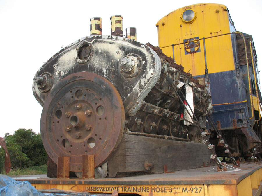

The QTTX has enough capacity (and room) that when you're sending an H-12-44TS halfway across the country you can send a V12-201A along for the ride.

S1 or S3? I spotted the narrow radiators, after that I'm lost. Yes, I could try looking up that engine but there's got to be other features I'm missing.
PostPosted: Sun Jun 09, 2013 10:19 pm
Posts: 384
Location: Reston, VA
S3 - the AAR type A trucks are the giveaway. An S1 has Blunt trucks.
PostPosted: Sun Jun 09, 2013 10:25 pm
Posts: 728
MLW S-3, former CP #6593, last used by the National Research Council's Railway lab in Ottawa, Ontario.
We have her sister #6591 at RMEO.
Steve Hunter
PostPosted: Mon Jun 10, 2013 1:45 pm
Posts: 705
I'm told that an Alco/MLW S1, S2, S3, or S4 can be identified as to the origin of the frame by the position of the front jacking pad (seen here above the front truck's brake cylinder) relative to the handrail stancions on each side of it. If the jacking pad is centered between two stancions, it was originally a 660 HP non-turbo model, S1 or S3. If the pad is offset to one side, it was a 1000 hp model, S2 or S4. My own observations have borne this spotting feature out. But were there any exceptions to this rule? I don't think it applies to the 251 powered switchers.
