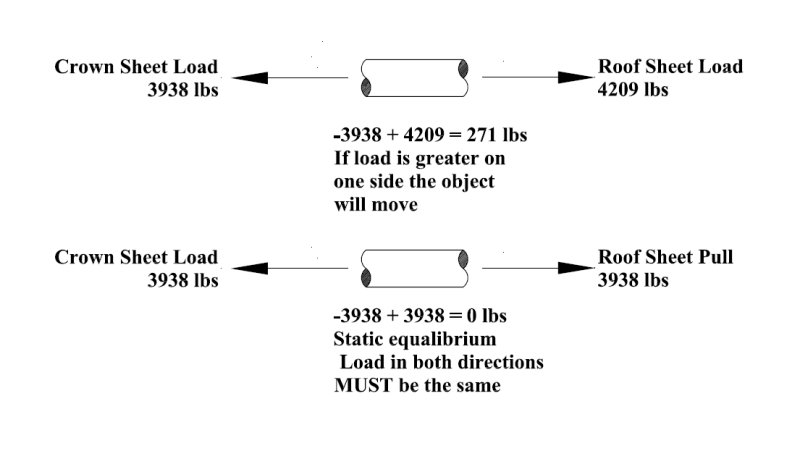

The correct stress value is E) 5014 psi.
Hint:

Shows why you don't do math with a 101-degree fever. And mistake the force on the staybolt for the stress.
Of course the resultants balance on the staybolt in question - the stress in tension at one 'end' will equal the stress anywhere else in the 1" section.

Posts: 489
Unless the boiler is exploding, the load on each end of the staybolt must be the same. All things being equal, (even sheet thickness) the extra load applied to the roof sheet due to the greater staybolt pitch will exhibit itself in greater "quilting" deflection than on the crown sheet. The greatest stress in a staybolt will always be the load of the smallest pitch area divided by the smallest cross sectional area of the staybolt.

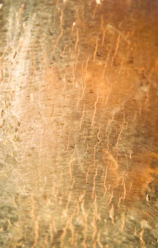

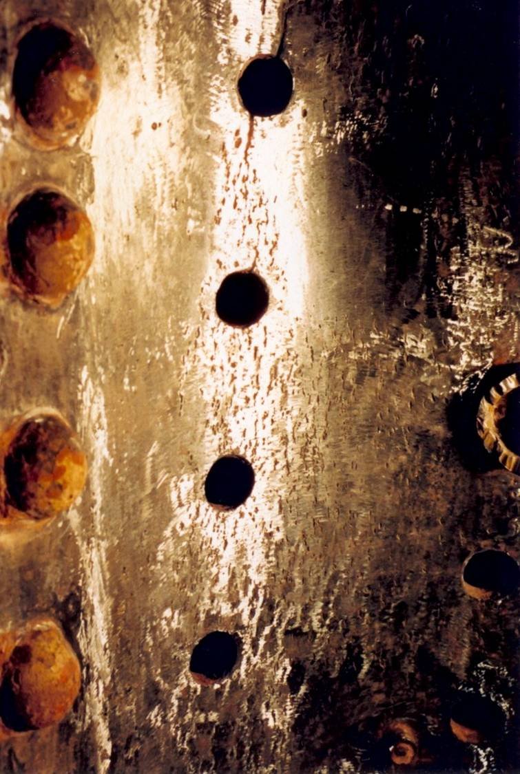

Stress cracks in large radius corners.
