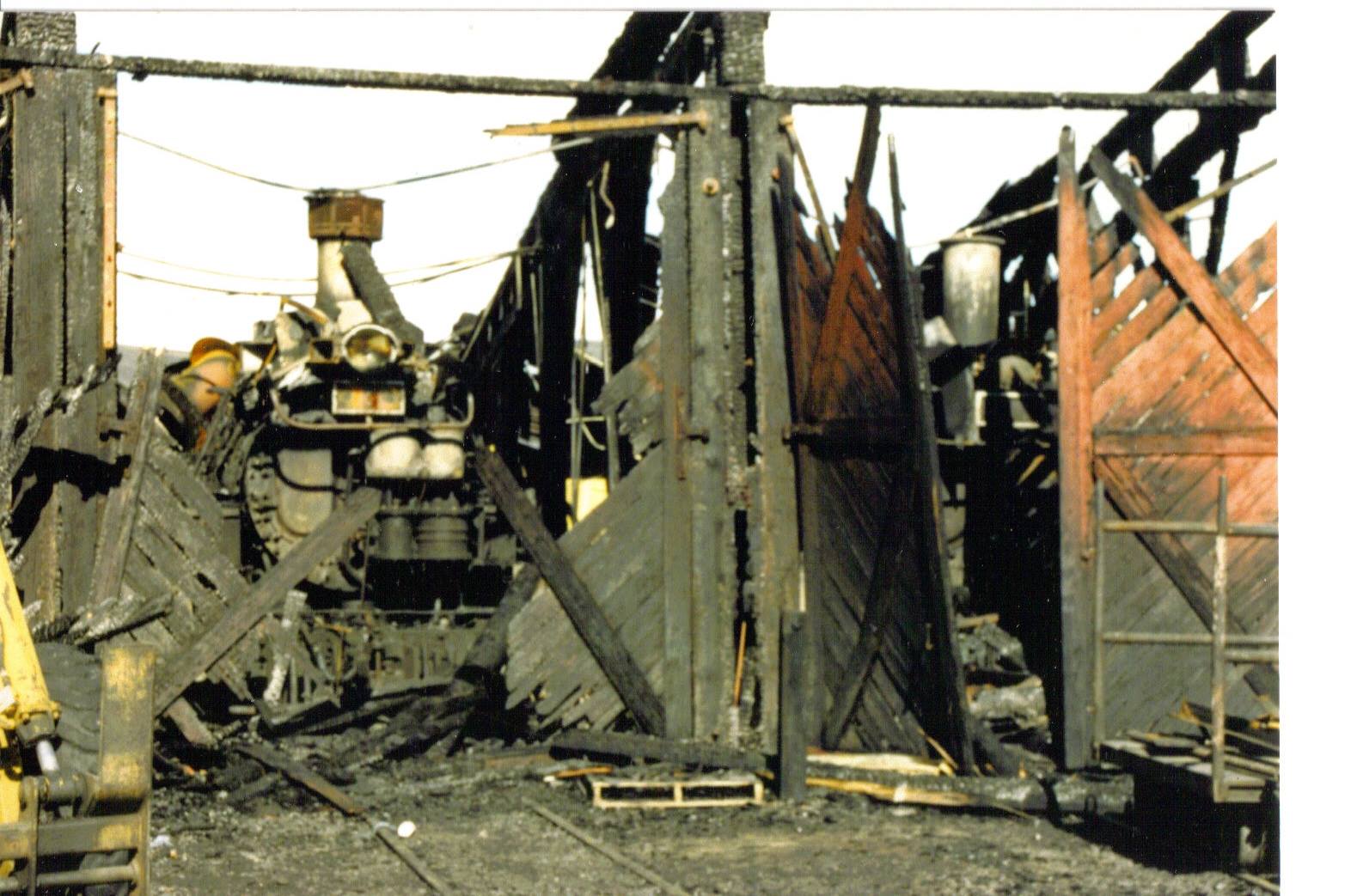

About everything on the Durango & Silverton was burned in the roundhouse and rebuilt.
February 10, 1989 the Durango & Silverton Roundhouse burned with 6 locomotive inside: 473, 476, 478 (Alco-1923), 480, 481(Baldwin 1925) and 497 (Baldwin/DRGW-1930). All survived and eventually returned to service.
10945855_1108258112524936_3539710862075410347_o.jpg [ 195.93 KiB | Viewed 5830 times ]
