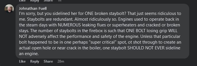

In case you're curious about why I think organizations are tight lipped, it's because you get takes like this from randos.
397483218_3486474931627160_1825727640173047797_n.jpg [ 34.14 KiB | Viewed 8746 times ]

He’s not wrong. Obviously I agree with 611’s decision - safety first. But nothing about his opinion is wrong, and he’s free to say it.

In case you're curious about why I think organizations are tight-lipped, it's because you get takes like this from randos.
That comment actually makes the opposite case. It's a reply to the official story on the repair, but it's just some dude. For many, his comment may not even be visible. It certainly won't enjoy the same level of engagement that the original post itself will.
Nature abhors a vacuum. Why let speculation invade the space when your voice can be the first and the loudest in establishing the narrative? Any organization should want to control the message, but you can't influence that if you don't participate.
Letting armchair critics or chum dictate your marketing/communications is also ill-advised. It's not about the jerks, it's about everyone else who is silent, but nevertheless letting their perspective of an organization be informed. When you look at the view counts versus reply counts on threads here, TrainOrders, etc –– the view count will always outpace the actual people making comments, and that's because there are plenty of wallflowers who are there to observe, learn, and form or reinforce an opinion.
There will always be critics or malcontents, but being concerned with those folks instead of actual legitimate or bonafide supporters, donors, passengers, etc is not a great strategy.
I can appreciate the desire for reticence and quibble with messaging or timing, and in this case, I'm fairly sure some of the same people who would have been in a position to deliver the message were actively involved in the process of repairing the locomotive, and there couldn't have been a definite timeline established for a return to service, or an expectation set for a follow up given the hundreds of paying passengers they had to take care of first. But how you respond to sudden hardship or unexpected challenges actually stands to define your organization more than any carefully prepared press release.
There can't be a real dialogue, narrative, or message established by your organization if you do not participate in it.

I am sure he would be equally desirous of sharing the liability for a catastrophic accident from the bad staybolt.

One bad staybolt doesn't create a catastrophic failure. It does, however, shift its load onto adjacent staybolts which then are more prone to failure sooner so dealing with them on an as-found basis is, in our litigious society, a very good idea. I think there was an old story about the PRR boiler explosion that happened when the firebox let go due to several broken and plugged staybolts all in the same area, which is what happens when timely repairs aren't handled when the problem is still small.
