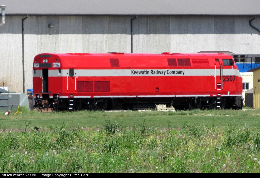

How's this for an interesting afterlife:
A native-owned shortline in northern Manitoba, the Keewatin Railway, has purchased some of these GE units and at least two ex-LIRR bilevel coaches to re-equip their mixed train service. They will supplement or replace a handful of tattered ex-VIA/CN blue and yellow cars and some equally worn out 4-axle EMD and MLW freight units.
https://www.youtube.com/watch?v=uQ8zCnEeZ24
Not sure what speed Keewatin's track is rated for, but I suspect it's closer to 10 mph than 100......
Greetings from Alberta
-an Articulate Malcontent
 Post subject: Re: Is it time to preserve an Amtrak Genesis P40?
PostPosted: Tue Nov 12, 2024 4:57 am
Posts: 2605
Well, I'll be, I figured someone would give it a try, but assumed it would be an established operation that knows the challenges with those units. I hope those guys know what they're in for all the way up there.
They apparently were worked on at the Wabtec shop in Albia IA, earlier this year, Butch Getz photo there (click to expand).

Here is a poor cell phone video that shows what the consist looks like: https://www.youtube.com/shorts/PCumszT36U8 I hope in the future someone can catch it running at track speed, which sounds like it is 10MPH. I'll bet those units won't like running in the first or second notch all the time.
