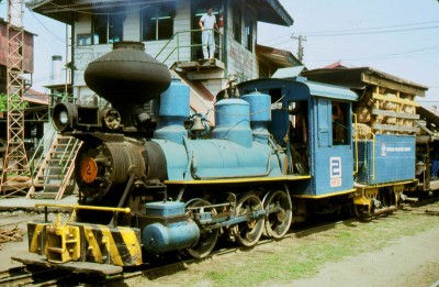

Here's a photo of one of these engines, still in service over there apparently, not sure what they did for a tender: https://www.steamlocomotive.info/largei ... hich=21234

The blue car coupled to the blue engine, and the black car coupled to the black engine, look to be wood rack tenders with roofs to keep the wood dry. The lower portion of the sides looks to be water storage, probably made from some old side tanks.... I'd guess.

Rather than wood racks, I suspect these tenders carry bagasse, the stems and leaves of sugar cane plants, which were at one time a popular fuel for sugar locomotives. "Omaloma," an 1883 Baldwin 0-4-2T at the Railroad Museum of Pennsylvania, was originally designed to burn bagasse and was later converted to oil firing.

Bagasse is the crushed pulp remaining after cane is milled, which was the main ingredient of Celotex wallboard. The leaves are waste, removed before harvesting by burning the fields. The stalks are crushed in the cane press to obtain raw syrup. Bagasse is a very low grade fuel, but it could be used in these engines, or in any woodburner. In poor countries, lineside wood racks are soon emptied by the locals, so it is common practice to carry lots of wood on the locomotive rather than depend on being able to fuel up out in the field. It's impossible to tell which fuel is used from that foto, but it could be either...
The previous post is correct that Bagasse was at one time a "popular" fuel in the sense that it was commonly used. It was not popular in the sense of being considered desirable. Little engines like the Olomana could only carry enough Bagasse to fire up from a cold start. After refueling, their range was quite limited, but she COULD have been used for weighing cars. On the other hand, her bunker looks like it could hold 5 or 6 barrels of oil, enough to fire that tiny boiler for a whole shift without refueling.
Bagasse WAS considered preferable to using dried "meadow muffins", another locomotive fuel used in hard times.
I am just an old man...
Sammy King

Yes she was HP(Hawaiian Philippines) #2. My wife and I bought her and moved her to the States around 2000.She burned bagasse and it was carried on top of a car similar to the blue car behind the loco in the photo above. As soon as I can "find" all my paperwork on her I will try to post some pictures of her. According to the people at HP she was retired mainly due to size. She could only haul 2 or 3 cane cars. I don't know how familiar you all are with sugar cane, but it is extremely heavy due to the high water content. Burning bagasse was very labor intensive due to its LOW heat content, generally 2 men on the tender breaking the bales down, 1 man feeding the fire(constantly) and an engineer- so a 4 or 5 man crew just to run the locomotive. I will post more on the whole story of the move if there is interest.

PMC wrote:
I am interested in the info you mention, among other things to update the record on steamlocomotive.info. Thanks!
From the owner:
She was HP(Hawaiian Philippines) #2.
Baldwin c/n 52199 in 1919
Photo in Philippines from owner.
