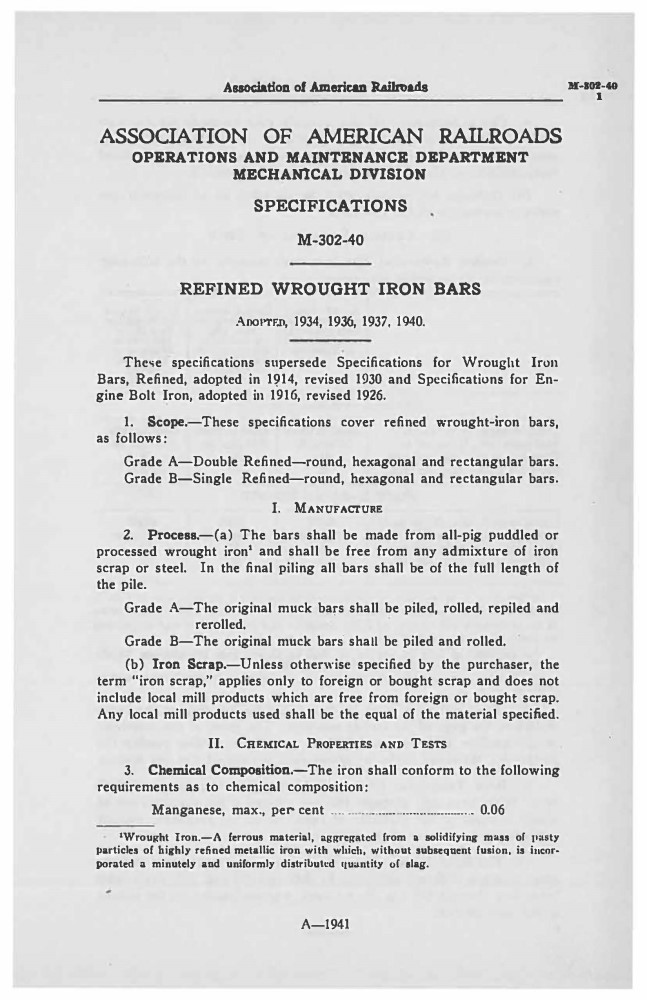

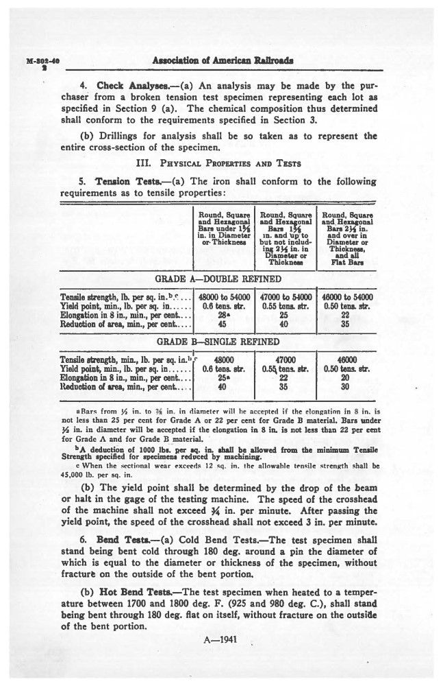

Matt,
THANK YOU very much for posting that pamphlet. It will be of great help. Do I read it correctly that the only chemical composition requirement is no more than 0.06% manganese?
NYCRRson - Those materials have already been mentioned but I'll leave it up to those in our group better versed in material selection than I.
This gives us a great starting place to determine what we'll use for the C&NW 1385.
Thanks to all for the input.......mld

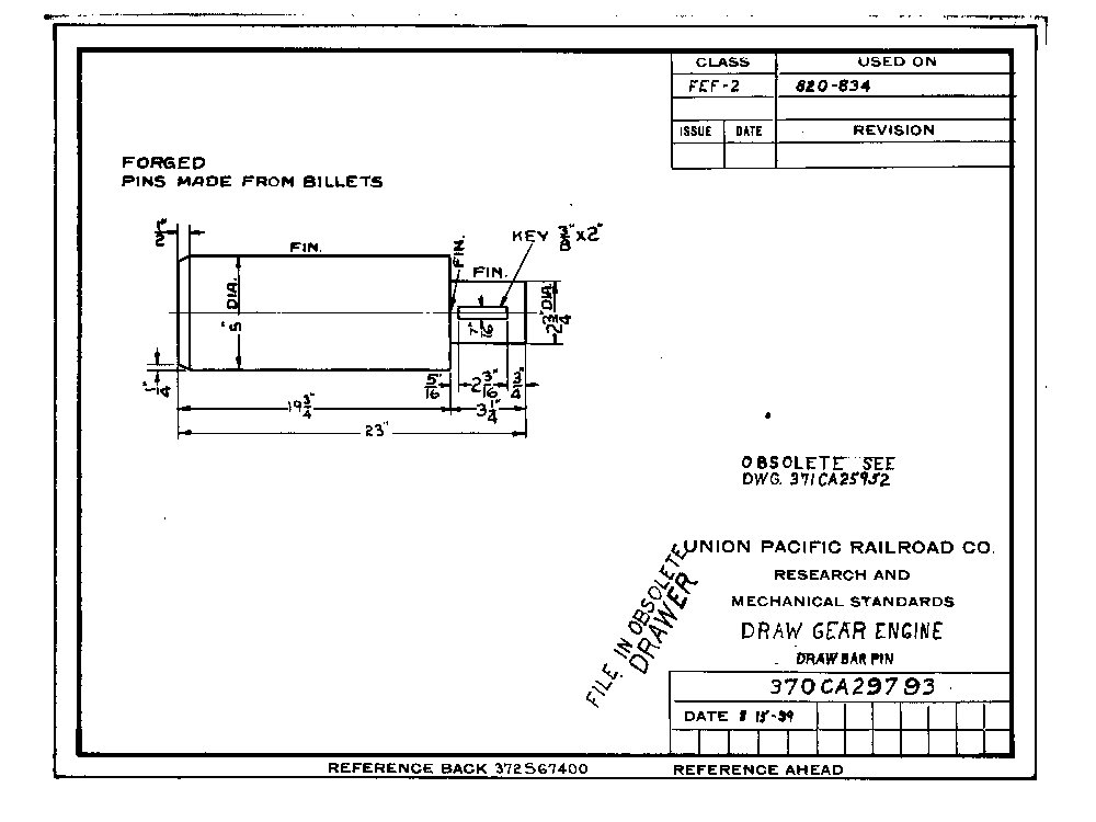

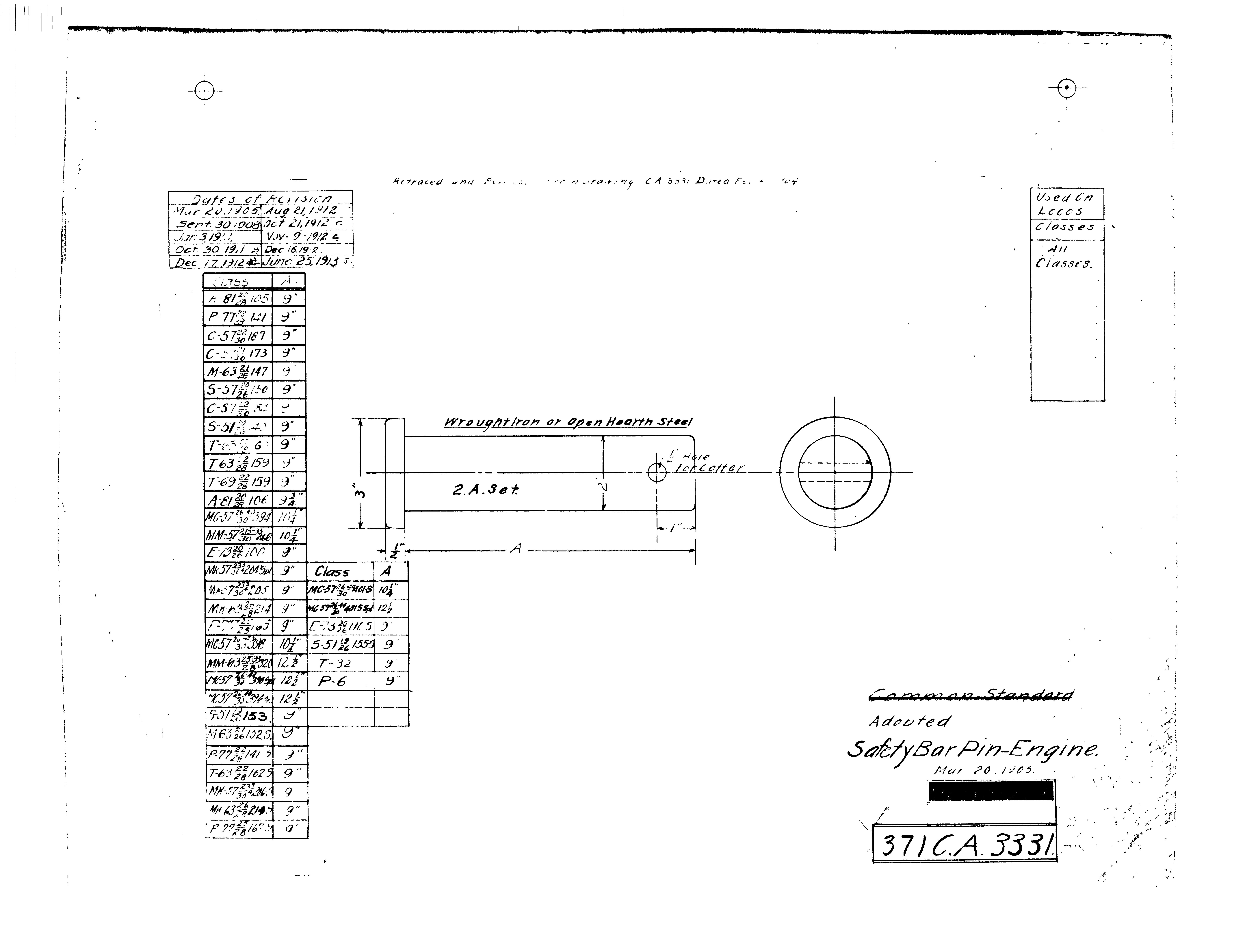

All the BIG power on UP had FORGED pins meeting UP CS-1-A/mild steel.
Drawbar pins from 1903 and before were wrought iron or open hearth steel. Wrought iron was not that strong but was immune from shear fracture.
And, yes, the only chem requirement for testing was manganese. However, the physical tests to pass were BRUTAL.
High-Res version 1903 Dwg.
