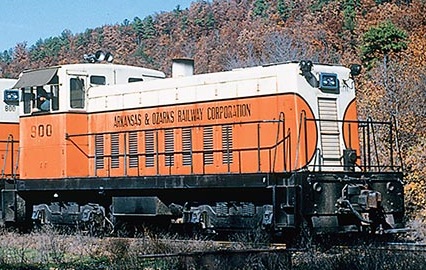

The Railroad has said that the Paint Scheme will remain in Black with a darker orange similar to what is Used on 16's Tender
BUT Alternatively, I feel that Cream and Orange would Look awesome running North or South on the Railroad
An Example is included below
Thanks
