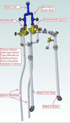

A screenshot of the piping of the Injectors on A-313. Two Penberthy #6 shown, but a second type unknown and not found was used on A-313 at the end of its operation. The two Penberthy Injectors are mirrow images of each other for clarity. The parts shown are typical based upon limited photos and should only be considered a tentative assembly diagram to illustrate what is known - not what was with certainty but more than was known.

I always enjoy your 3D modelling. High tech approach to a low tech locomotive.
Just for clarification, the injector manufacturer is Penberthy.
Roger

Corrected in Text and Graphic. Spelling which is not my forte.
