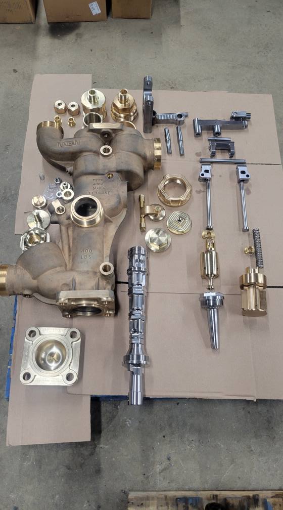

"Chris Huffman
April 12
I think it was a little over a year ago when Jason Johnson asked if I would be interested in helping with a project. Little did I know that 14 months later, we would be where we are today. Bringing the first Nathan 4000Cs into existence since the end of steam. A massive undertaking to say the least.
When I started my machine shop, I really didn't know what I would end up doing. While I enjoy doing job shop work, these are the types of projects I really enjoy doing. It helps fulfill my commitment to helping keep steam preservation viable for the future, while helping so many different organizations at the same time.
So. Many. Parts.....and this is just the first one!
Pictures are roughly in chronological order, so you can flip through and see the progression from raw material to finished product!
Of course, this project would not have been possible without the vision of Jason and the T1 Trust, the injector expertise of Anthony Duarte, and the help of other good friends in the steam preservation industry as well as my material vendors and local friends who assisted.
I think I'm going to go to bed now."
58 photos and videos (at the link above) of the machining process for parts of the injector (too many to post here).
489906736_2818901494977829_7495173990648796126_n.jpg [ 70.36 KiB | Viewed 65477 times ]
