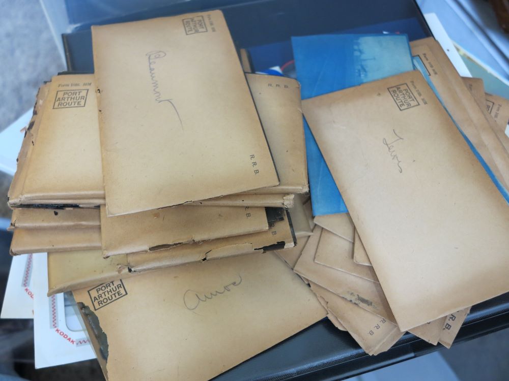

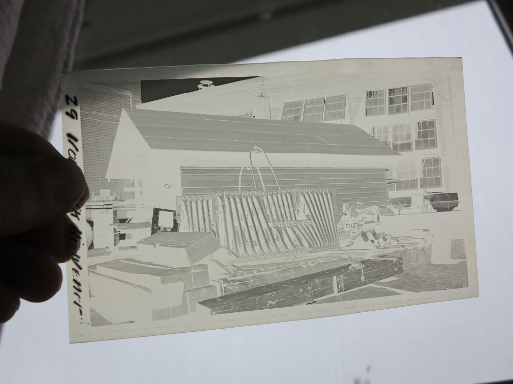

I recently acquired an inordinate amount of 100+ year old negatives from the Kansas City Southern. These are 4x5 and 5x7 negatives that date from 1912 to 1935. These were photos taken by the KCS and kept in their files, they cover everything from every structure at every station along the line to roundhouse expansion projects to early grade crossing accidents and everything in between.

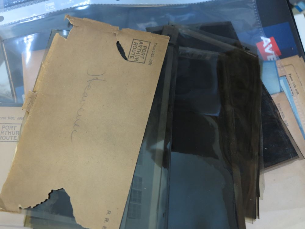

The negatives were stored in kraft paper envelopes, with every negative for a given subject stored together in the same envelope. While many of the negatives have survived just fine, others, not so much. Some of the negatives have become stuck together while others seem to have fused into a solid brick inside the envelopes.
The ones that are just stuck seem to be the result of some sort of moisture causing the emulsions to stick together, some will separate with gentle lifting (and no apparent damage), while others have become very brittle at the stuck spots and break if you look at them wrong.
The ones that have fused into solid bricks seem to have undergone some sort of chemical transformation, to the point of fusing with the envelope and oozing a black, tar like substance through the envelope. My guess is that heat is responsible, but I don't know for sure.
Does anyone have any suggestions? I can say definitively, despite what everything I could find says (and despite my experience developing black & white film decades ago) water is not the answer. I tried soaking some in a tub of water and it took less than five minutes for the emulsion to completely dissolve and become just a disgusting slimy cloud in the water. That said, the negatives did separate into nice clear, blank squares of whatever.

While I know soaking the negatives in water works for some, and has worked for me in the past, I can not over emphasize how much it does not work on these negatives as all it did was remove the emulsion from the backing in a matter of minutes on the batch that I tried. Thus, I shall not try that approach again!
As to whether or not it qualifies as a "large collection", I suppose that is a personal definition. Considering that it has taken over our dining room and adjacent parlor, my wife would vote that yes, it is a large collection. From a numbers standpoint, I started with a 14x10x8 box packed as tight as possible with envelopes of negatives. Thus far I have managed to sort and file about 1500 negatives, there are about that many waiting to be dealt with and probably that many that are sitting off to the side as stuck together or brick status. To me, it qualifies as an inordinate or excessive amount of negatives, if not a large collection.
As to what I am going to do with them, I am not sure yet, I figured step one was get them into a better storage format and in the process organize them and figure out what is there. To that end, I have been placing the negatives in 4x6 photo pages and thence into binders, organized by subject. Once that is done, it will be time to decide what comes next.

Given the age you mentioned these are nitrocellulose film. They are highly flamable. When the film base brakes down it turns to a gel and releases sulferic acid fumes which attacks the silver in the image. The best place to store them is in a freezer. Good luck with your project.

Thank you for the information. Nitrocellulose film seems to be an exquisitely lovely material!
Chemical decomposition definitely explains what has happened to some of these negatives and why separating them is proving impossible. Moisture has not stuck them to each other, the material itself has decomposed and welded the negatives together.
It is interesting to see how it has happened, given that these negatives have been stored together and in the same environment as each other for their entire existence. Most are AOK and look like they were made yesterday while about 40% have suffered some sort of failure, ranging from becoming welded together in spots to every negative in an envelope Turning into a solid brick.
I really can't find any rhyme or reason as to which negatives bit the dust and which did not. All were placed into kraft paper envelopes by the KCS and remained there until now. The envelopes range in condition from as new to brittle piles of disintegrated paper shards, the condition of a given group of negatives seems to bear no correlation with the condition of the envelopes that contained them. A new looking supple envelope is as likely to contain ruined negatives as not and vice versa. Also, the number of negatives in the envelopes does not correlate with their survival. Groups of 100 negatives stored in the same envelope seem to be just as likely to have died as those stored in groups of 1. 5, 10, 20 or whatever and vice versa. My best guess is that it would come down to slight inconsistencies in the various chemical processes that the negatives were subjected to during manufacture and processing.
