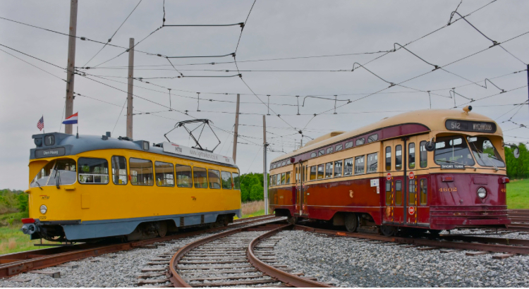

We operate pole and pan cars sharing wire at National Capital Trolley Museum.
~Wesley
File comment: HTM 1329 (pan) and TTC 4603 (pole).
