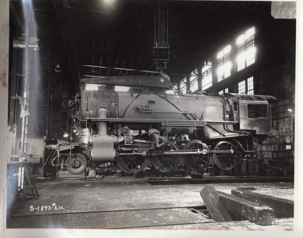

Images are a booklet describing Nathan lubricators, injectors, etc., that the
Army required the manufacturers to include with the locomotives and a photo of one being assembled at ALCO shared with me by Kevin Kohls.

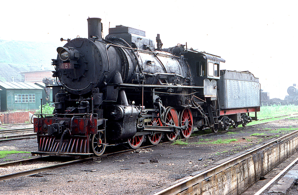

Photo I took of Chinese class KD-6 (S-160), possibly Baldwin-Lima-Hamilton, at Fushun open pit mine in July 1987.
(I removed my original scan for an improved version per advice from a friend more experienced with Photoshop. Dick Morris please substitute this one for the original to use, thanks).

PaulWWoodring, do you mind if I post your Chinese photo on the Engine 557 Restoration Company's Facebook page?
The three manufacturers of the S-160s were ALCO, Lima, and Baldwin. Baldwin-Lima-Hamilton didn't exist until after the war.
About the only way to tell the manufacturer of an unknown S-160 if you can't determine the USATC number is the shape of the builder's plate (missing on your photo). If you can actually inspect the locomotive, a serial number is stamped on the rear of the frames (at least that's true of those from Baldwin). The numbers were also stamped on a number of components such as side rods and valve gear at the factory, but in service the parts were swapped between locomotives. Even the factory would mix things up, the cab and cylinder block on ARR-557, BLW serial number 280 19s 809, have the numbers of other locomotives that never came to Alaska.
No, I don't. Please include a photo credit with your use of it.
The caption for the image came from my notes at the time during the trip. I'm sure the description of the builder came from one or more of the others on the trip. A couple of them did get up close to the running gear to see if they could find any serial numbers that might be a clue. I think I remember someone saying one component was stamped "LLW", and thought that might be for Lima. I was a little fuzzy back then as to when Baldwin merged with Lima-Hamilton (I was the youngest person on the trip at 30), also the exact dates some of these engines were built was not clear, although I am now sure that they were delivered to China before the 1949 Revolution, so yes, it would be either a Lima or Lima-Hamilton product, if that stamp is for the builder of the entire engine, and not just the specific component.
