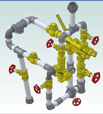

Posts: 154
A couple of views of the revised Injector setup on Climax A-313. Modified to reflect the actual piping found. The biggest changes are to Tail Pieces which connect to the Injectors and the two (2) Check Valves which I had not identified due the quality of the photos and lack thereof. No other real changes.
Valves are modern but will be changed to period pieces when I have time. The LEADER is correct as to size, etc., but the Handle is done from a dimensioned photo.
