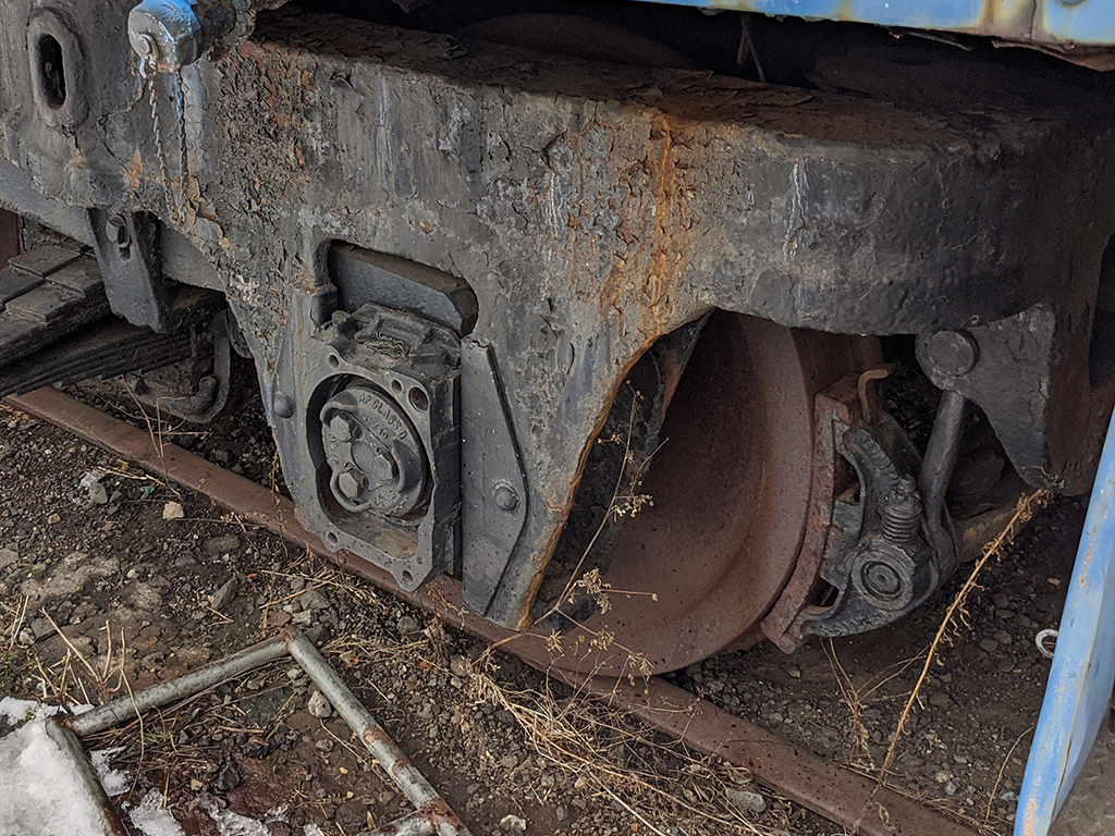

Yes, I'm talking about completely replacing the bearing box in such a way that would permit the car to be moved in interchange service.
Here's an example of a former CN heavyweight Pullman car that has had this conversion done.
