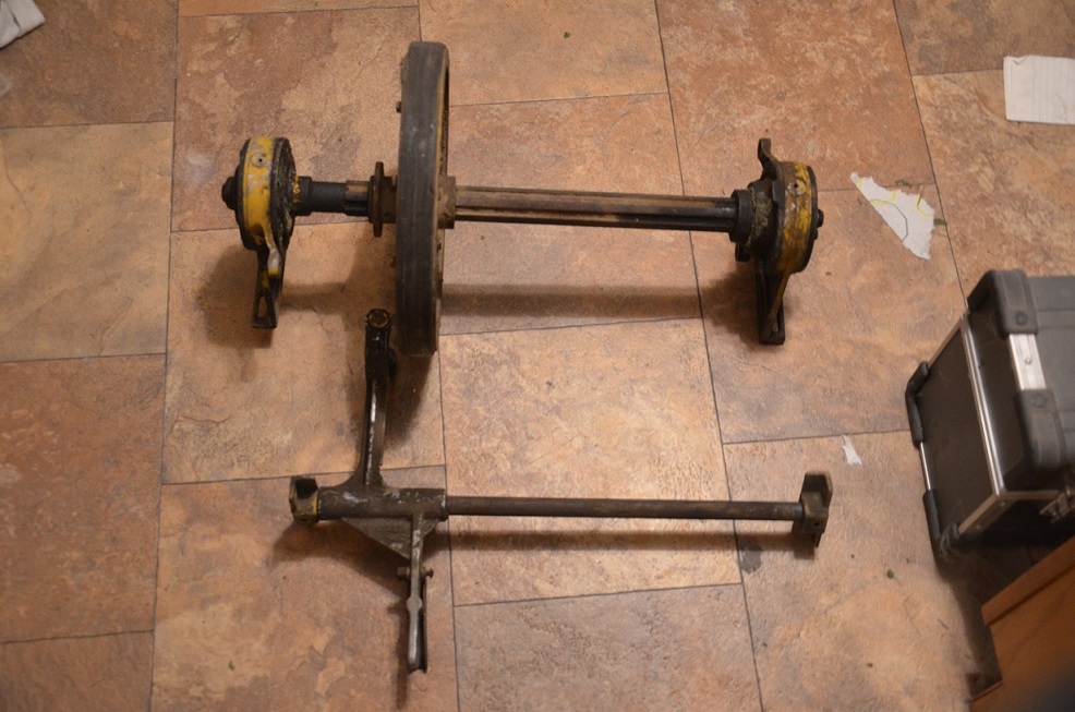

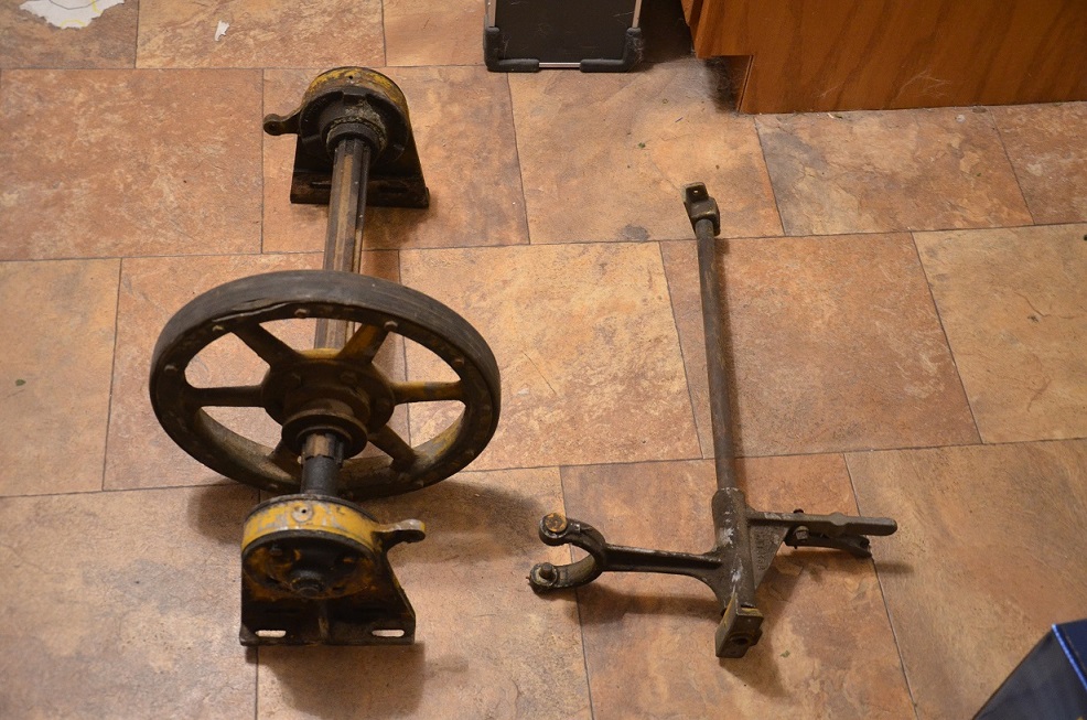

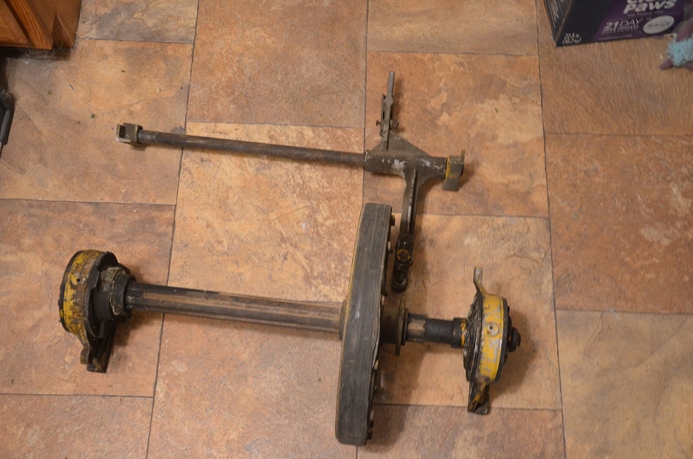

Hello I have 2 FM model 101 motorcars, also have some extra parts for my cars attached pictures of the drive.
The older 40b motorcars used a square shaft for the drive the 101 used a spline shaft like buda motorcars. Does your car use the Linkert carb?

Yes, my car utilizes a Linkert carburetor and off the top of my head I believe it is a model M1B.
Do you have any more photos of the Model 101 drive? I have never seen a photo of a complete drive in it's entirety. I am missing one of the two levers that I believe connected to part of the spline shaft you describe. What were the functions of both levers? I have been unable to determine that myself.
