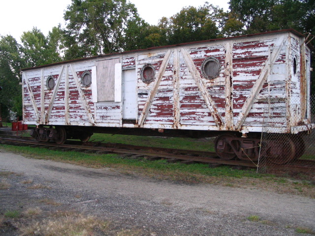

It's late. The winter wind is howling outside and the temp is dropping! There's new snow on the ground. A good night to check the internet and doing so, found this outside braced boxcar:
http://www.rrpicturearchives.net/showPi ... id=1406920
Looked at the photo and got to wondering if this was a rare piece of equipment that somehow got preserved? Yes, there are quite a few outside braced (single sheathed) boxcars that got saved, but look close; this one had its wood sides converted to steel! This was probably a fairly common way to get some more miles out of an old car and other roads besides the Frisco, did it I'm sure. But how many of those conversions have been saved? I don't recall any, but maybe I missed them somewhere along the way. So.......is SL-SF #162739 a rare bird in railroad preservation? Please let me know, one way or the other. And thanks!

While I don’t doubt there aren’t a lot of these around, some quick googling turned up at least one other example. That would be Atlantic and East Carolina 606, impeccably preserved at the NCTM.

Thanks! A beautiful example of an wood outside braced boxcar converted with steel sides. So, there are at least two surviving!

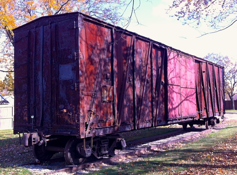

I got to thinking about IRM's UP #100000 and something clicked in the back of my brain (happens less and less frequently these days). Did some checking here on RyPN and found a photo of another Union Pacific steel boxcar with outside bracing. I had found that car sitting on an out of the way siding at Greenfield Village in Dearborn, Michigan and Chris Salmonson was nice enough to send in a photo of that car. I can't figure how to transfer it over here, but if you want to see it, look up the 2012 thread "Update from the DT&M Roundhouse". Although I can't transfer THAT particular photo, Mike Pannell (of Car 57 "fame"), discovered a bunch of old freight cars, one of which at least, looked like it could have been a sister to the car at Greenfield. I'll try to post it here:
http://car57.zenfolio.com/p412775893/h4 ... #h401cc0f2
My apologies if I screwed something up! Anyway, in that other thread, Dennis Storzek pointed out that the car at Greenfield Village was BUILT as a steel car, circa 1915. So, neither of these surviving Union Pacific outside braced steel cars is a conversion from a wood sided car.

NS 3322 wrote:
Les, is this the car you are talking about?
No, this one.
http://www.rypn.org/forums/download/file.php?id=4384
Here is the discussion:
viewtopic.php?f=1&t=33511&p=185741&hilit=union+pacific+greenfield+village#p185741

Dennis has furnished the photo of the correct car (although the DT&I car is neat). When Chris Salmonson originally posted that photo of the Union Pacific 50' Automobile boxcar, he stated that Greenfield Village was eventually going to restore it. Wonder if anything has been done in the last few years?
Well, so far we only have the SLSF and A&EC outside braced boxcars converted from wood to steel sides. So maybe those two really are "rare birds"!
