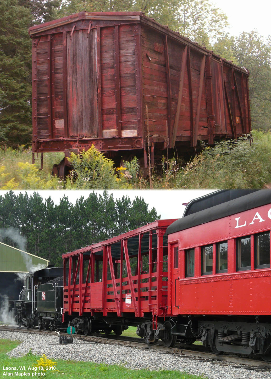

I recently discovered what I think is a Soo Line wood outside braced boxcar at the Iron County Historical Society in Caspian, Michigan. Any ideas as what its number is?
I also photographed another Soo Line wood outside braced boxcar at the IXL Historical Museum in Hermansville, Michigan. Any ideas as what its number is?
Are there any other survivors?

NS 33322 -
From the windows and door added to the car in Caspian, it appears that the Soo converted it into a camp car of some type.

The car at Caspian does not appear to be a Soo Line car, possibly C&NW.
Hard to tell about the other car, but physical attributes mark it as one of several thousand built by AC&F in 1913, 14, and 15.
IRM as three similar cars from the Soo, built in 1913, 1914, and 1929. There are several others in various museums around the country.

Laona & Northern Railroad (Camp Five Museum) has one, converted to an open car for the Lumberjack Steam Train.
Dennis - If the car at Caspian really IS a former, C&NW car, I think it might be pretty rare. I think there are a few Soo Line outside braced (single sheathed) boxcars in existence, but I can't seem to recall any C&NW o.b. boxcars.
Dennis -
I found another existing Chicago and North Western car:
https://www.midcontinent.org/equipment- ... nw123576a/
Not sure if Mid-Continent applied the outside paneling to this outside braced car, of if it was done by the North Western. Anyway, the car apparently survived as a company service camp car. Not sure if the road number is one that was used when the car was in regular service.

Les,
If you click ahead couple photos, there is a builder's photo:
Same diagonal brace at the lower ends of the sides, same attachment of the end posts to the outer face of the end sill (the Soo cars all run behind the sill). I think we have a winner.

Ron Travis wrote:
What is it that suggests that the car in the first post is C&NW rather than Soo Line?
Well, Les came up with a matching C&NW car, so that's what it is.
But from a Soo historian's perspective, MOST Soo Line single sheathed boxcars shared the structural angle side sill construction exhibited in photos of the cars at Hermansville and Laona above. On these cars the side posts ran below the sill and connected directly to the cross bearers. Some other roads had similar cars, but the Soo really liked this construction, and ended up with similar cars from four builders. In fact, they only had three small groups of cars with conventional channel side sills:
750 36' cars built by AC&F in 1912 that were virtual copies of the Canadian Pacific's Dominion Car & Foundry cars. These had the same end sill construction as the later cars, with the end posts running behind the end sill.
200 door and a half auto cars built by AC&F in 1924. Aside from being auto cars, these had pressed steel ends.
250 boxcars rebuilt from older cars at North Fond du Lac in 1950 and 51. These rebuilds did have the end posts attached to the outer face of the end sill, but had modern all steel diagonal panel roofs, unlike the boxy wood fascia showing in the photo of the car in question.
Finding no possible match in the Soo Line fleet, and knowing that the DSS&A didn't have single sheathed cars, The next logical source was the C&NW, which turns out to be correct.
Les,
Oh yes, I see the diagonal brace on the C&NW cars. I don't know if such a brace was ever used on the Soo Line cars. If not, that confirms that it is not a Soo Line car.
However, I could be wrong, but I recall learning that Soo Line outside braced cars were built in both versions of the bottom Z connections to the frame; one with the Zs attached to the outsides of the side sills, and one with the Zs attached to the ends of cross beams. I will have to dig out my old Soo magazines.
 Post subject: Re: Soo Line Wood Outside Braced Boxcars
PostPosted: Mon Sep 02, 2019 8:31 pm
Only on the North Fond du Lac rebuilds of the early fifties, and those had all steel roofs. In addition, they used a continuous steel band below the side plates as the connection between posts and plate, rather than the triangular gussets.

So, it would be nice if we could now find the road number for the C&NW car there in Caspian. John T. suggested a couple of places to look. Also, the number was sometimes painted on the underframe, usually toward the center. And some roads painted the car number on the inside, next to the center door. Not sure what the Chicago and North Western's policy was.
