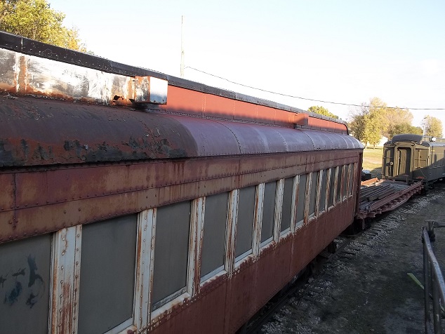

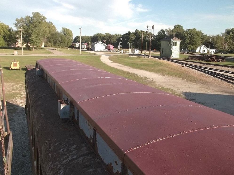

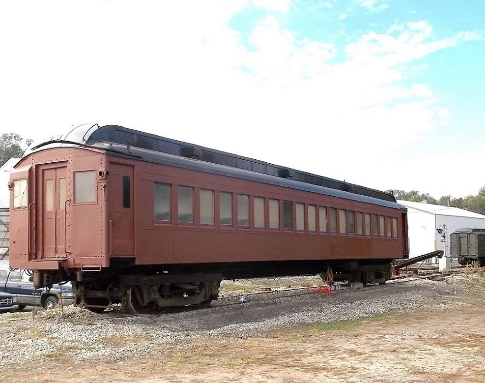

Mr. Knebel has started in on our Erie Lackawanna commuter coach #3328. Built for the Delaware, Lackawanna & Western as their number 676, it has a long history including ending up at the Indiana Transportation Museum in Noblesville, from where it was acquired.
The first photo shows the car shortly after its arrival at HVRM last year. The second shot shows the roof this week after Mark had cleaned it up and the last photo shows about half of the roof in Rustoleum primer.
Two work photos by Mark Knebel with the "roster shot" by yours truly.

Thanks for the kind words. Mark finished putting the primer on the roof of EL 3328 and then applied a coat of black paint, which he states is ACE brand Rustplate. Photos are below.
