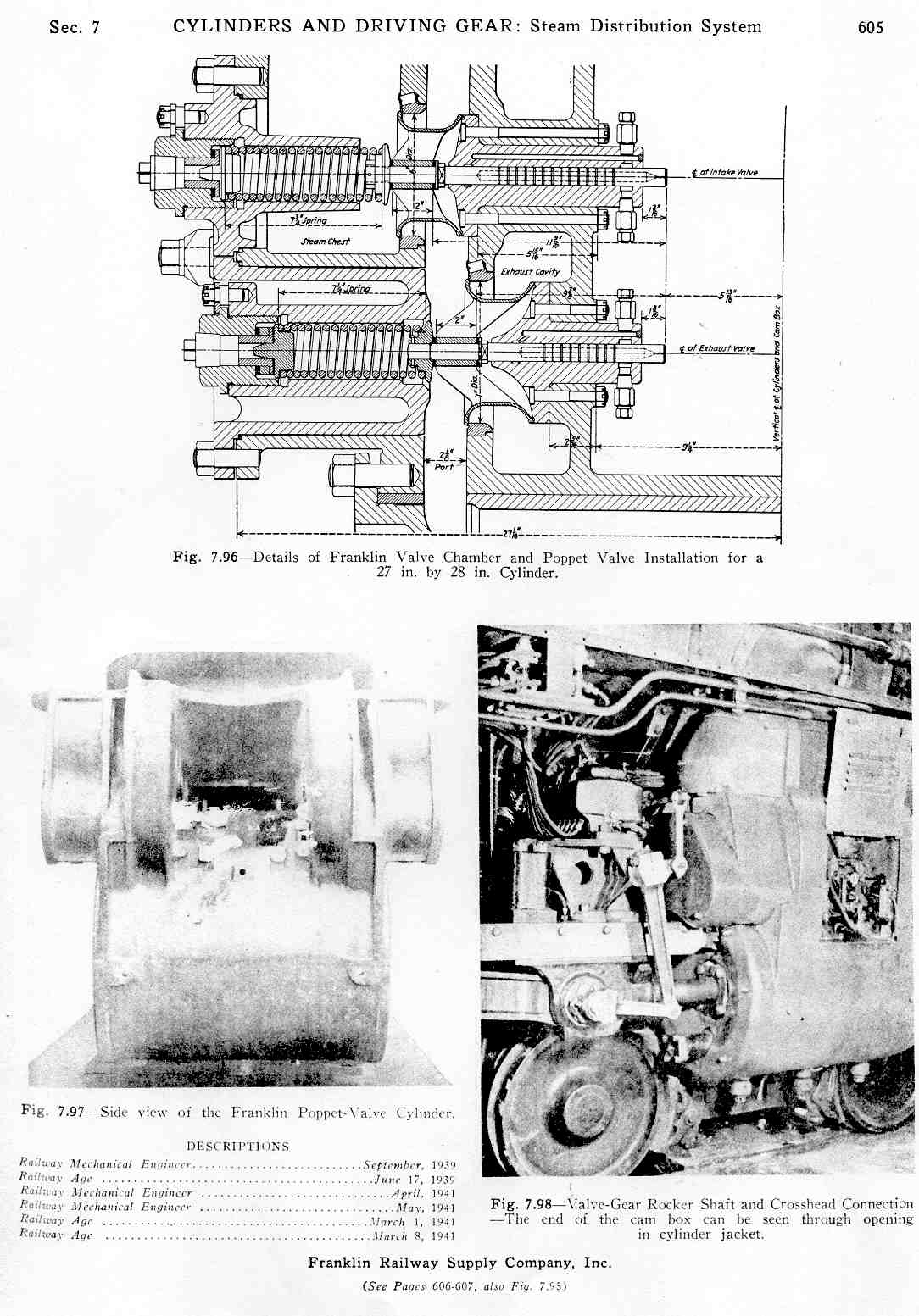

And the final Franklin page.

On CNR 6184 I wonder how much had to be done to the engine to convert it to the poppet valve gear. Did CN have to make a new cylinder saddle? Or were they able to make use of the existing casting, for example.
 Post subject: Re: USATC 2-8-0 No. 611
PostPosted: Sun Jul 07, 2013 6:53 pm
Posts: 445
Location: Ontario, Canada.
"Equipped with Poppet Valve Gear, applied to existing piston valve cylinder castings at Montréal Shops, 1949. One 14-in. piston valve in each steam chest replaced by two 7-in. diam. admission and four 7 in. diam. exhaust valves."
Joe,
It appears they used the existing castings and the photos confirm that.
Again, I wonder how much advantage this gave over the conventional Baker gear? That would be very interesting!
The locomotive was relatively new (1940) so they probably couldn't get too drastic a "re-do" past the "chief"! They went back to Baker gear and she ran out a few good years of service.

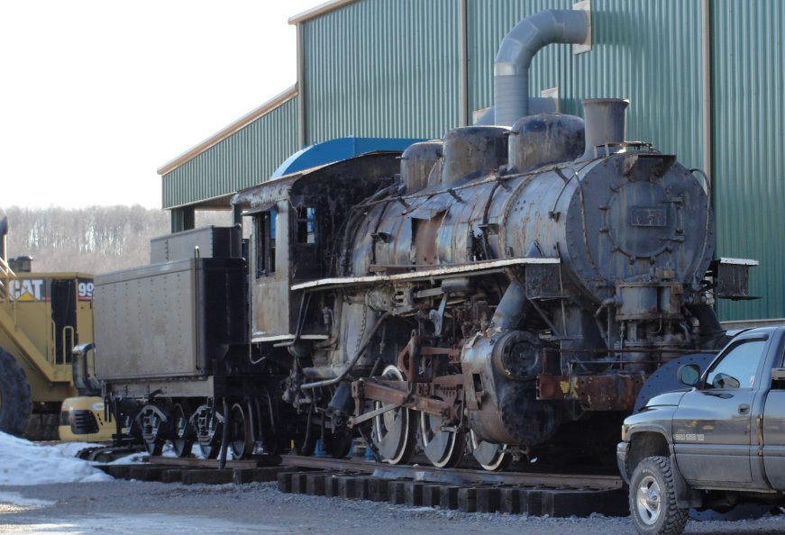

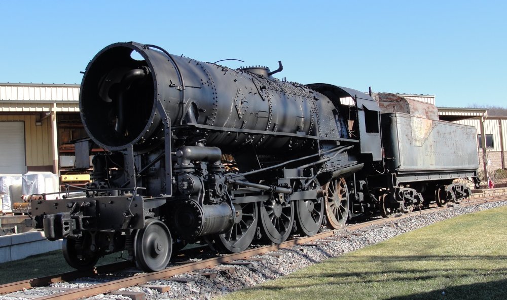

Former US Army locomotives photographed at Bill Miller Equipment Sales, Eckhart Mines, MD - January 18, 2013

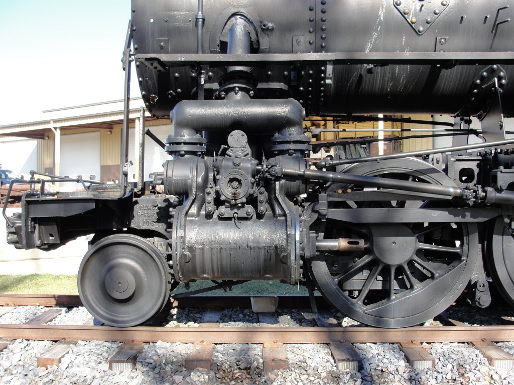

One additional image showing some detail of the valve arrangement.
PostPosted: Wed Jul 10, 2013 12:10 pm
Posts: 1341
Location: South Carolina
^ Nice photo; thanks for posting. As I said earlier, it would be really interesting to know how well this system (referring specifically to this "one-off" Franklin gear installed on USATC #611) worked from a thermodynamic standpoint. It would have certainly been a lot easier for a "non-steam" engineer to operate as the reverser only had 3 positions- forward, "neutral" and reverse.
I also wonder if it might have been beneficial from the standpoint of preventing runaway slippage.
Hugh Odom
The Ultimate Steam Page
http://www.trainweb.org/tusp
