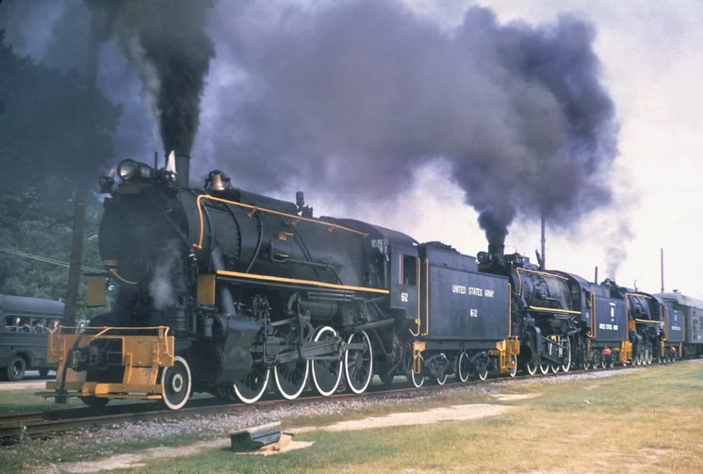

Fort Eustis was a haven for train fans into the 60s as the Army was still teaching steam operations and running their WW2 locomotives around the post.
Much like the Jeeps and GMC 2.5 ton trucks, the S-160s were designed for a relatively short service life. Nobody told that to the running examples (like my 1944 Willys Jeep in the garage which still runs but has never been restored), and these locomotives were made in the same spirit.
Three of them did a triple-header trip on the Ft Eustis RR for the 1963 NRHS convention, one of the last hurrahs for Army steam.
