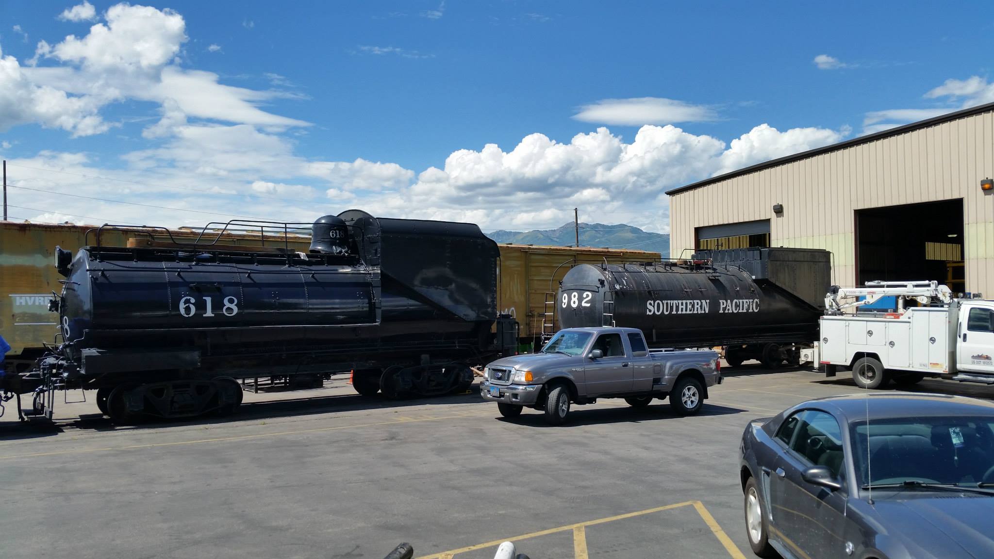

The Southern Pacific 982 tender is without its mate in Heber. The display where 982 sits is to small for both engine and tender so the options where to either. Scrap the tender, Cut it in half for it to fit, Or donate it to somewhere that needs it. The chose to donate it. It had many parts essential for an oil burner still on it. So with the HVRR converting to oil they thought this would be a good idea. The tender though is to big for any of the engines. As seen in the photo below. Also years of park display was not good to it. When I saw it it was rusted through in many parts.But the oil bunker was intact with heating elements and gauges. It also retained its emergency shut of valves. For some odd reason this oil tender had a emergence valve at where it went into the loco witch is where the only 1 should be but the 2nd one was where they loaded the oil on to the loco. There shouldn't of been one there. But the HVRR doesn't seem to mind as now they have valves for both of there steam engines now. The tank is going to be put inside the once coal bunker of 618 is what I hear. But no promises to that.
Photographer Credit goes to Parker Wilson a great guy who volunteers many hours at the HVRR.
File comment: Photographer Credit, Parker Wilson Source FaceBook page History of the train in Heber City Utah.

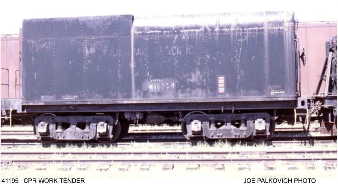

Another one that held on a little longer...
