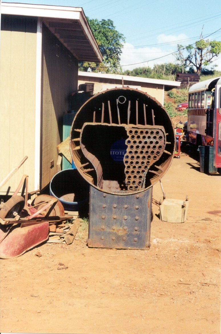

 Post subject: Re: Boiler condition NOT A FACTOR *PIC*
PostPosted: Sun Aug 05, 2001 10:37 am
> By the way,
> whatever happened about the boilers they
> made with the dogleg stays?
At last count 8 of the first 26 were de-certified into Boat Anchors. Present condition of the Queen of the Boat Anchor Fleet can be found at the following link.
PS. Even a brand new ASME boiler can blow up even WITH lots of water over the crown sheet. Buyer BEWARE!!!!!!!
Boat Anchors AWAY!!!!!!!
