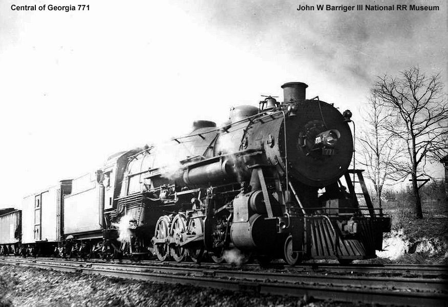

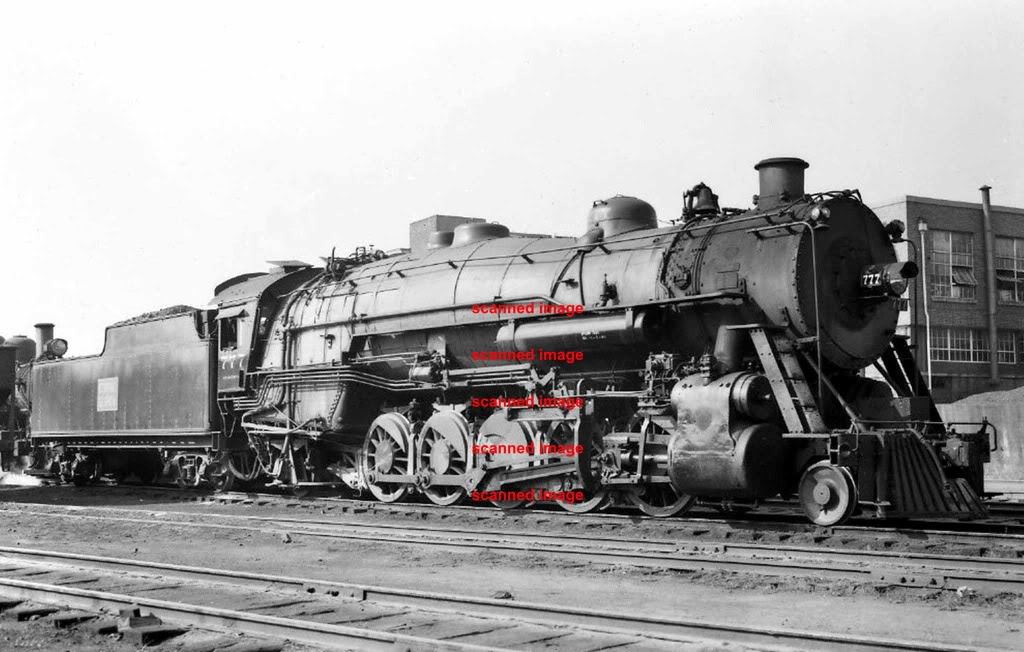

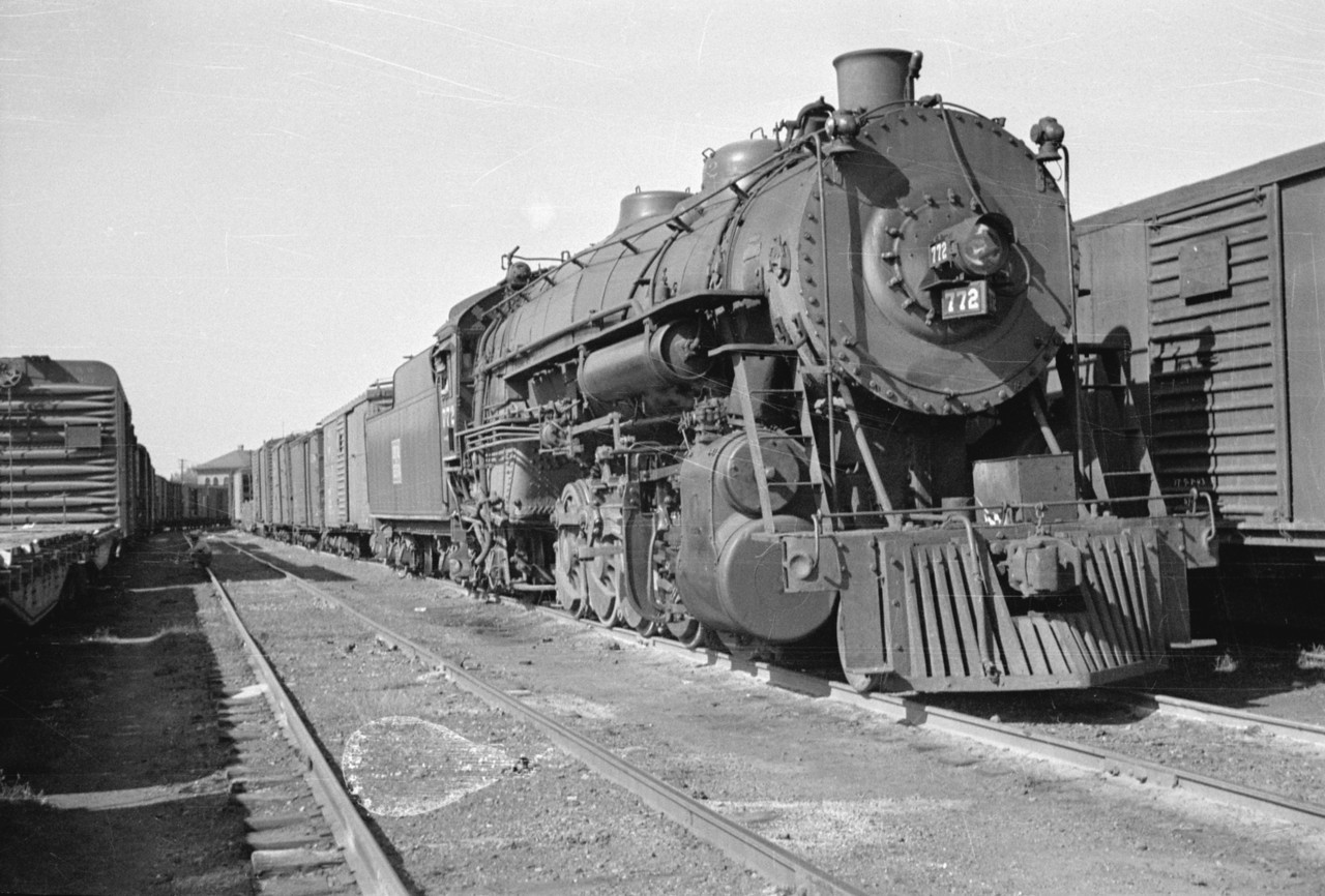

4501's current tender is not from a Central of Georgia J-1 Class #701 - 709. The evidence is found in the frame. An extension cast by the Glover Machine Works was added to the frame at some point.
As I pointed out in my May, 2014, Trains Story about 4501, the current tender came from a Central of Georgia Class J-3 2-10-2 built for the Illinois Central. The CofG lengthened these tenders to increase coal and water capacity (from 15 tons and 9,000 gallons to 18 tons and 12,500 gallons).
The J-3 2-10-2's were numbered 771-777. I have found pictures of a few of them and only one, the 772, had the rounded coal bunker as found on 4501's current tender. I've attached a picture of the 772 showing the extended tender and rounded coal bunker. Also, attached is a picture of the 777 to show the straight coal bunker found on the remainder of the J-3's. Finally, a picture of the 771 with it's original short tender is attached.
File comment: CofG Class J-3 #771
File comment: CofG Class J-3 #777
File comment: CofG Class J-3 #772

Mr.Ray, Many thanks for the greater understanding. Sadly I read the Trains article then passed that issue over to my brother (4501 is his favorite from the Southern Steam days) recalling only the C of Ga tender source. Then when visiting last week with my father I snapped a pic of the drawings for the J-1 and J-2 but not the J-3. Anyhow, thanks for posting the photos of each J-3 tender type. Right shape, right capacities, right all vertical rivet pattern (based on older pics of 4501 from the 70's).

Interesting number "plate" on the 772 as well.
 Post subject: Re: Southern # 4501 tender 2 part question
PostPosted: Mon Nov 17, 2014 1:32 pm
o484 -
The CofG eventually went to this type of number plate identification. I don't know of any other railroad where TWO number plates (as on 772) were on the same locomotive at the same time. Does anyone know of any others railroads where this might have occurred?

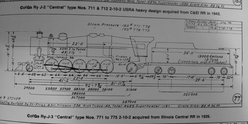

I visited my dad again and snapped a pic of the J-3 Diagram. I'm guessing coal capacity indicated here did not reflect the increase in tonage from the modifications. Regarding the J-3's pictured in this post, the 771 was retired in May of 1952 after suffering a boiler explosion, and the 772 and 777 were retired in August of 1952 per Richard Prince's book on the Central of GA.
File comment: C of GA J-3 2-10-2
