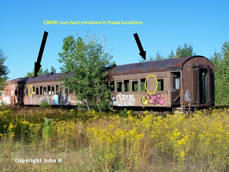

artschwartz wrote:
The car that loooks like a B&A coach may very well be one of the C&NW coaches that were sold to the Rock Island. Externally, the cars were almost identical. If it has roller bearings and a toilet compartment, it is, as B&A cars had neither. The Rock Island numbers were 2615-2623.
Art -
Thanks for the numbers of the Rock Island's ex-C&NW cars. Then the 2500's were numbered 2500-2614.

I might be wrong, but looking at the photo with the rattan seats, it would almost appear to be a former NYS&W coach. In the early 1960's the NYS&W purchased several cars, supposedly former B&A, and used them to replace Budd stainless steel coaches. Around 1963 or so, the state of New Jersey funded a mini-rehab of several of the cars. They received some minor mechanical repairs, paint, and interior work that included the removal of the luggage racks and the installation of standard coat hooks on the walls. The current phot sort of indicates the same thing but perhaps other railroads followed the same practice? I've seen photos of one NYS&W coach that also had vinyl seats added but I'm not certain what the other cars had for seats. IIRC the NYS&W had 6 coaches. Passenger service ended in 1966.
A very interesting set of coaches none the less. I'd bet some railroads could really use those open-window cars.
Rob

Alan Maples wrote:
At one time there were a number of passenger cars parked at various points along the Southwest Pennsylvania Railroad, with a variety of owners and most with mechanical defects of one sort of another. I looked at these particular cars about three years ago and concluded they probably came from Chicago commuter service. They were not of interest or use to us.
Alan Maples
Everett Railroad
C&NW cars had more windows than their D&H/B&A/NYC/NYS&W counterparts but were otherwise very similar in outward appearance. There were two more windows per side on the C&NW cars.
