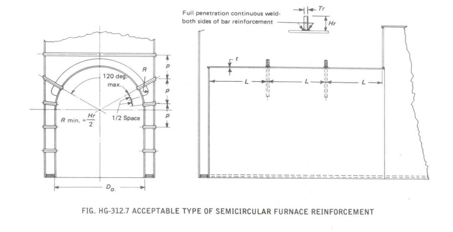

The ASME Code does not require telltale holes is staybolts attached by welding.
Duh, I wasn't thinking. I've seen many examples of cracking, including transverse cracking in welded staybolts......it is my opinion that the ASME code should require telltales in less than 8" regardless of the attachment method, but that's only my opinion.
I'd guess that the crown is semi-circular and is self supporting?
Also looking at the stay positioning in the backhead, it looks like the water legs on the sides could be a little cramped?
I have seen some Hurst boilers scrapped within 3 years of installation (new boiler) due to weld cracks. Most of them do fine, but a few have had issues. No matter who the manufacturer is, there have been staybolt issues with cracks and welds in Scotch Marine type high and low pressure boilers.
AMEN.
Semi-circular crowns with transverse crownbars are allowed in Section IV 15 PSI Heating boilers but not Section I Power boilers. Care to guess again?
It's too late....I'm going to bed.
I've run a SCHEIDLER traction engine, which has transverse crown bars on a fairly flat crown sheet, and also seen a FRICK portable engine that has a semicircular crown with no stays nor bars. This was what I was thinking of when I posted, but both were built prior to ASME. As I understand it, my experience is on one of only two Scheidler engines remaining.....all of them blew up, including one killing Mr. Scheidler whilt testing at the factory.....
The stay pattern is a bit strange on the backhead....I'll assume that the topmost four stays may be longitudinal stays? The next row down (at the firedoor) is closer to the centerline than the remainder below........which makes me wonder what the inside of the firebox looks like.
