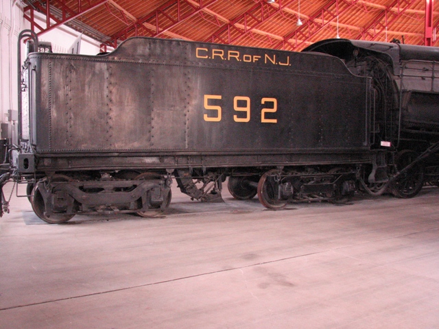

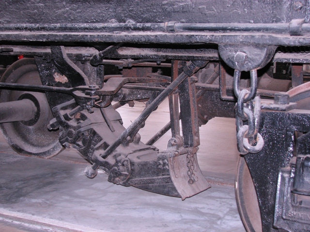

I think I have seen scoops on a couple of preserved PRR steamers and I think the B&O President Washington. Others?
The Jersey Central Camelback at the B&O Museum still has one.
