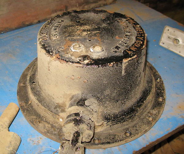

For whatever it's worth, here's a picture of a Pintsch gas regulator loose from a car. This unit was salvaged long ago from a car being scrapped.

great picture good job in rescueing something that some of us will never see ! You could get a good mould made from that.
Mike Pannell
