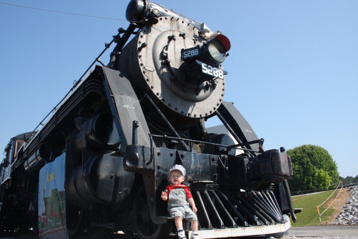

Yes, she was donated to TVRM by NPS. Although she does have a few missing pieces, they can be replaced readily (well, with some $$). Her running gear does appear to be zero mileage and her shop records confirm the essentially zero mileage status. It does appear that she was given a break in run after shopping due to the very light soot on the flues. How well the external shell fared under the jacket and lagging in the northeast winters will be the determining factor in the difficulty of her rebuild when the time comes. Those of us that inspected her supposed the biggest hurdle would likely be the flexible stay sleeves and caps. Unfortunately, rotten sleeves mean new bolts. Her tender is fairly well shot around the bottom and the coal bunker (expected) and the stoker screw is yard art or a mailbox post in the waiting, but overall, she is a very good rebuild candidate as retired locomotives go.
Michael Brown
Logistics coordinator for the 5288 move
TVRM
File comment: My nephew at Day Out with Thomas really took to 5288. Fortunately, my son was more enthralled by the Famous (I'm not one for brainwashing, but proper instruction of children is necessary...). No, the Emily banner wasn't meant to identify 5288, as there were several hung around the area for photos with the children. Emily does, however, have the correct paint color for a restored 5288!
