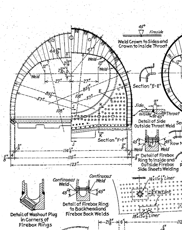

 Post subject: Re: Tornado Boiler
PostPosted: Mon Jan 17, 2011 6:37 pm
PostPosted: Mon Jan 17, 2011 7:51 pm
Bobharbison wrote:
A couple of years ago we purchased some "e" clip rail fasteners from a reputable supplier here in the U.S. They were imported from India, but they met the specs and hard the right paperwork.
That's known as the Xerox certification. As in, find someone who has a valid certification, and Xerox it.
That's the same reason I just passed on a pair of Chicom safety shoes. Who knows if they really meet spec., or if they just forged the certificate. I'm not about to risk my toes to find out.
PostPosted: Mon Jan 17, 2011 8:40 pm
Posts: 1326
Location: Pacific, MO
This version makes sense. It's probably forged and fits up to the side sheets differently than the Tornado's. The German piece is machined and looks butt welded to the side sheets from what I can tell in the photos.
This would be easier to wash the boiler than the traditional mud ring and as you say, cut down on places for grooving.
PostPosted: Mon Jan 17, 2011 8:44 pm
Posts: 1341
Location: South Carolina
The Germans apparently used the U-shaped butt-welded foundation rings on welded locomotive boilers for a long time. There may be a problem with the execution or the materials used on Tornado, but the concept appears to be well-proven.
PostPosted: Tue Jan 18, 2011 11:44 pm
Joined: Wed Sep 01, 2004 10:05 pm
Posts: 38
Location: Martinsburg, WV
Let's be clear on a view things. The Tornado's TROSS style of mudring is not a U shaped, pressed plate as shown in Mr. Austin's photos. It is a U shaped channel milled out of steel bar stock approx. 6" square. And yes, Mr. Porta found good performance from this design. I like Kelly's post of the drawings of the 1937 D&H all welded boiler mudring showing this design but using a milled shelf that the sidesheets set on. The sidesheets were only seal welded to the mudring with threaded and driven staybolts going through the lip of the mudring and the sidesheets. Also, Dave's admonition that "in the absence of any real facts, it is way too easy to blame what is unfamiliar in our practice just because we aren't familiar with it." Or to quote Mr. Porta, "what I don't understand is necessarily wrong!" DB Meiningen has built maybe 35 locomotive boilers in the past 25 years with high quality and great success of performance, economy and longevity of service. They have built all welded boilers with welded staybolts in steel fireboxes. I doubt if any steel plate quality or welding/workmanship problems will be found. It's great that the A-1 website has been so forthcoming with the details thus far. Let's see what they find and fix in Meiningen. How much do you think the following may have caused these problems? 1. Fire up practices that greatly stress the boiler, staybolts and firebox. 2. Over the road firing practices - problems - and resolutions. 3. Thermal cycles of the boiler. 4. Does the standard British plate frames design properly and adequately support the boiler? Certainly these problems will be fixed and we will see many years of fine running from TORNADO.
