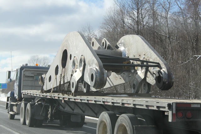

filmteknik wrote:
I've said this before. The reason making giant complex steel castings has become a lost art is because welding technology has improved to the point they mostly aren't needed. Someone could probably take that design and break it up in to sections to be either cast or fabricated from stock shapes and then weld it up. Careful consideration would be given to where the joins would be and probably special areas created for that purpose.
That might be better than going through a costly learning curve to make it all at once. If you screw up a section you re-do just that piece. Still need a huge annealing furnace though.
Steve
Recently on a road trip to Chicago to pick up the fam at Midway Airport, I passed something on the Indiana Toll Road that made me think of just this line of discussion. It was so interesting that I had to dig the camera out of the bag in the passenger seat, then slow down and let it get past me enough to grab a shot one handed. I'm sure the truck driver thought I was nuts, but, then again, who isn't? I am quite certain this was headed to Caterpillar or a similar manufacturer.
It certainly proves that locomotive frames need not be a one piece casting but could be more affordable fabrications built up of plate, structural shapes, machined components, and castings. Seeing things like this and other recent steam restoration and repair makes me believe not only can it be built, but can still be made right here in the USA (surprising, I know). With Backshop Services, TVRM, Strasburg, and others, a properly funded project could come together rather quickly.
