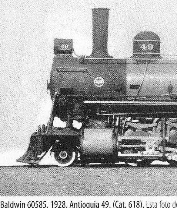

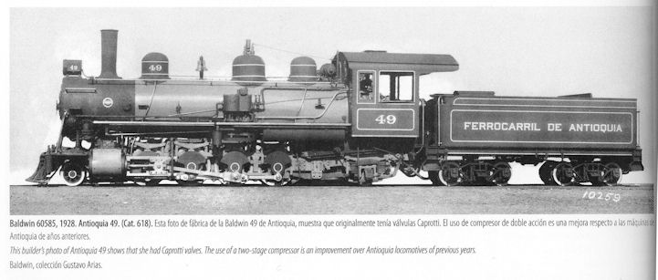

I just found another Central American narrow gauge Baldwin fitted with Caprotti valve gear.
"Ferrocarril de Antioquia", 3'+ 6" gauge, #49, 2-8-2 of Columbia. Page; 1401 in the 1930 Locomotive & Car Cyclopedia (hopefully Brian has a copy of this photo also!).
Just like the mention in the #152 photo, it says; "with Caprotti valve gear".
The #49 has only 19,500 Lbs of Tractive effort, so it would be small for 3' gauge, but for a 3'+6" gauge steam locomotive its tiny.
The Caprotti "part" of the steam chest looks the same as that of the #152, but the top of the steam chest also appears to have less width and less height than the #152 has. The cylinder block casting looks very similar to that of the #152.
 Post subject: Re: "IRCA" 150-153 Baldwin W/Caprotti valve gear
PostPosted: Thu Mar 31, 2011 2:53 am
Well, I do not seem to have a photo of the locomotive. Although I think I have another cache of BLW/Broadbelt prints.
I must admit that besides being involved with railway preservation (many years active with Orange Empire) I am fascinated with narrow gauge roads. Particular emphasis is western roads with active research into the Carson & Colorado/SPng. But I find the Central and South American roads very interesting and very fascinating.
I looked in Christopher Walker's Narrow Gauge in Columbia: Railways and Steam Locomotives and did not find a photo of the #49. This book out England did not even offer rosters.
I then looked at Gustavo Arias de Greiff's La Segunda Mula de Hierro / The Second Iron Mule subtitled History of the Columbia Railroads through their Locomotives. And in it I found a copy of the builder's photo. And a roster of locomotives.
By the way, the Antioquia was a 3'-0" gauge operation.
File comment: From the book "The Second Iron Mule"p. 218
File comment: close-up view of the cylinder
The number 618 refers to the line entry in the roster section of the book.
There we find that the c/n was 60585 and built in 1928
    cylinders 16x20
    diameter 40"
    rigid wheel base 11'-0"
    total wheel base 25'-0"
    weight 85,700
    total weight 109,500
    T.E. 19,500
The note about the locomotive is "Con valvulas Caparotti. En 1985 tenia valvula piston."
There were a number of similar locomotives without the Caparotti valve gear that can in 1927 and 1928. From my reading of the notes some of these were kept for tourist trains in the mid-1990s.
