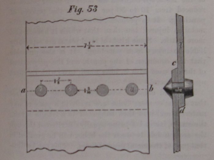

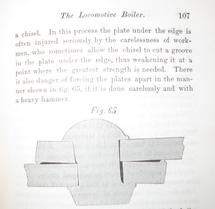

I see how to make just about every mistake possible; Pg. 107 fig. 55. The only thing they did not do wrong was that they missed cutting into the sheets with the rivet heading/setting tool.
So in the Fig 53, the two sheets fit together ideally, there is no divergence of either sheet after the riveted joint, the hole is perfectly sized, the rivet was perfectly sized and headed and it looks like a perfect joint. It looks like the builder did such a good job of this joint that no one is ever going to improve it with a chisel.
I'd like to see some examples of bad joints improved with by caulking, thats what makes the term "caulking" seem like a magic trick at this point (of my very early boiler education).
Is there ever any real caulk (putty made for boiler seems) introduced into a boiler for any reason? If so, when and where would it be acceptable to use some type of liquid sealant in a boiler seam or tube/flue joint, (other than on threaded joints of course)?

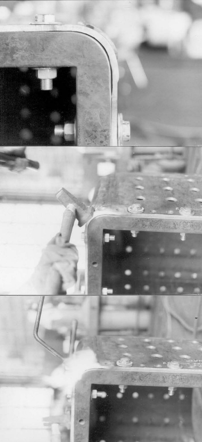

Proper Caulking requires proper "Layup" of riveted joints. Plates must be metal to metal contact without residual stresses. This is accomplished by fire, flatter and hammer, usually. This is the layup for Claus' boiler on Maui.

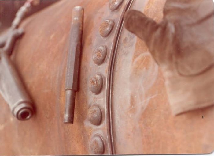

Kaipu at Grove Farm on Kauai recieved a new welded front barrel course riveted to the existing second course. This is the caulked seam.
