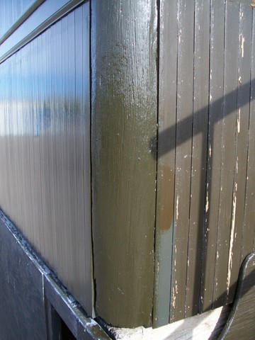

After a couple of attempts Sherwin Williams have come up with a great match to our original colour sample, the picture shows 4 colours one of which is latex, then a lighter awful attempt, then Sherwin Williams first match attempt which was a very dark olive/brown probably good for sleeper cars, then finally tinted slightly more green we come up with a superb dark Olive.
Thats it....no more mixing !!

Did I hear latex? Why would anyone even consider latex?
Just as an aside, the paint adhesion on your end siding seems to be failing already. If the surface prep was the same on the whole car, it's not really worth investing the time to do the striping, because it will only last a couple years before the surface needs to be stripped again.
I don't really have a suggestion... Uncle Sam took away all the products I used to use, but a lot of folks on this list seem to have good luck with epoxy formulated for marine use... Awl Grip comes to mind.
