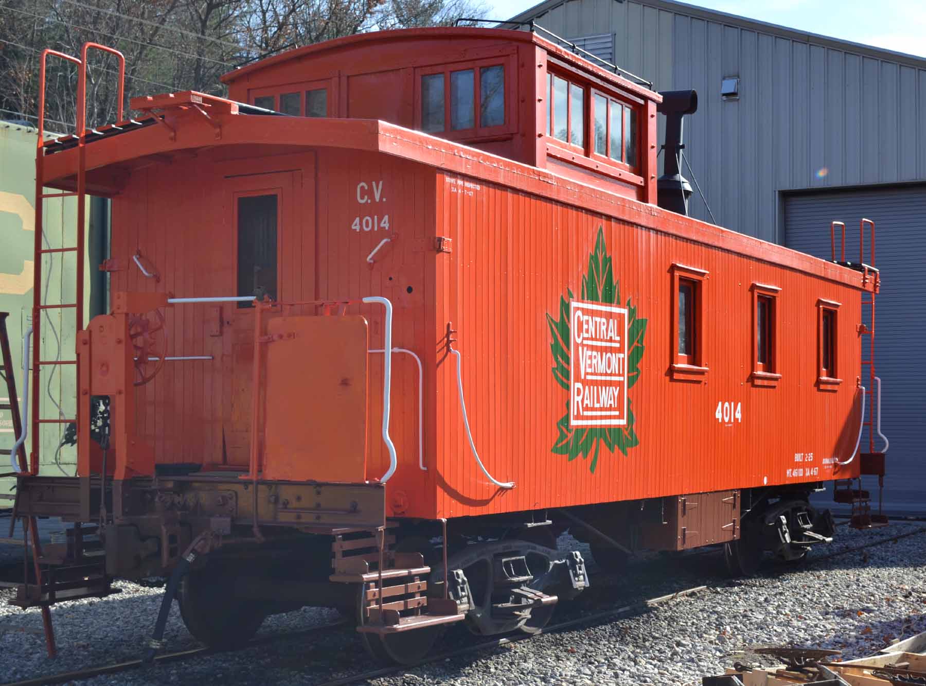

The caboose came out of the Steam town collection, was transferred to a local Group (VHRR Bellows Falls) from whom i purchased as they disbanded.
Ironically the other CV caboose in the collection which had been acquired by donation from the Vermont Railway, deemed to be in better condition, was moved to Scranton and is now in ruins as the roof has collapsed, not unlike most of the other wooden cars moved to Scranton that remain outside. They are all basically ready for the dumpster as they have not received the periodic roof repairs that were done by the Volunteer Group in Vermont to keep them watertight. I doubt that any will receive the attention at this late date to keep them from going back to mother earth.
Al P.

 Post subject: Re: EPDM roof on CV wood caboose
PostPosted: Fri Jan 13, 2012 1:30 am
Joined: Tue Sep 21, 2004 1:32 pm
Posts: 114
Good save, she is an absolute beauty!
Taylor

That is really nice looking... really looks no different than the original wood and canvas. Certainly looks better than leaving all the roof hardware off for fear of penetrating the roof membrane. The round edges don't particularly bother me, given the greater likelihood that the boards will be intact when I view them, rather than partially rotted away.

I noticed the roof decking on the CV car is perpendicular to the roof line vs parallel. Is this the way it was designed or was it changed during a previous rehab? Just comparing designs, since the cupola is one way and the body another.
We looked at using EPDM on our N6b, but were concerned about the holes for the hardware voiding any warranties. We also replaced everything on the roof, arched supports to decking and we wanted to try to keep original dimensions. We also weren't sure about 1/4 plywood/luan and whether it would flex enough around the arched roofline with out cracking/splitting over time. Ended up using standard asphalt roll layered over T&G with smooth side of T&G joints up.
Since the car is not under cover, we'll see how well it holds up and may go the EPDM route next time. So far the roof is leak free.
You can see it at www.wvrrm.org.
Bill

What type of paint did you use on this car?
Thanks
Bill
PostPosted: Fri Feb 17, 2012 11:29 pm
Joined: Wed Jan 11, 2012 2:31 pm
Posts: 61
Bill,
Paint is Valspar tractor paint Case orange. it was a spot on match to a CN orange paint chip. we have been using this paint on a number of projects around our railroad museum. when i compared to The Sherwin Williams Industrial enamel i used on first paint job that is now $100.00 or so a gallon compared to about $35.00 a gallon for the valspar. Orange is a tough color outdoors, so i will see how long it lasts. if memory serves the good sherwin williams started fading after a couple of years.
