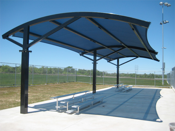

While not perfect, I think this is about the right idea for most park engines:
File comment: Fabric Structure
The efforts people make to give these shelters the appearance of "railroad architecture" are ill-conceived. The result is often a bad parody of the historic architecture I have a great affection for.

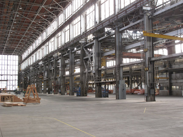

File comment: Mare Island Building 680
Randolph Ruiz

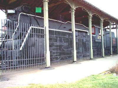

This locomotve was mentioned on the first page , but no picture , Pat
File comment: At Moncton, NB

Randolph -
This fabric structure is VERY interesting! It solves the problem of photography and "visibility" by making one side of the the locomotive completely post-free. It also appears to solve the problem of bird droppings. It may even be somewhat cheaper to build than a structure with a wood or metal roof. And if installed with a chain link security fence such as that shown, it would probably be fairly secure, although I would put the posts closer to the rear of the chain link fence, rather than toward the front. This design also appears to be expandable to accomodate a longer engine, or one coupled to cars. I must admit that I don't know how a fabric roof such as this would hold up over time, but perhaps a replacement down the road if necessary, would be fairly easy to do, and perhaps not that expensive since the components are already in place.

Posts: 328
I searched for cantilever canopies and noticed a variety of materials for the roofing, including steel and glass. I am curious how heavy and deep the foundations would have to be to account for heavy snow loading on these cantilevered structures.

I like the "idea" of the fabric roof, but wonder about:
a) Durability- how long will the roof last?
b) Protection- how much protection will it provide to precipitation?
c) Size- Single track application looks appealing, but could it be expanded to 2, 3 tracks?
I managed a building with awnings made from traditional stretch vinyl fabric commonly used for this application. After about 10 years the fabric began to fail from exposure to the very elements it was designed to shield - sun and precipitation. A major ice storm weighed them down and the fabric failed. So you'd have to be prepared for a 10-year life if you go this route. Your mileage may vary.

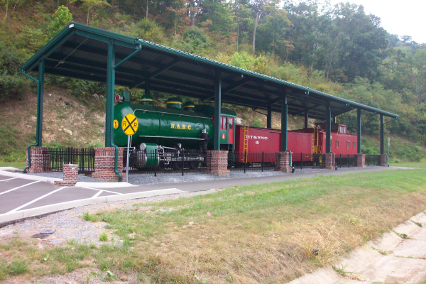

Posts: 380
Location: Hickory, NC
Here's one in Elizabethton, TN... I do like this one, particularly since it has a security fence and a high roof. Perhaps the brick pillars, which DO dress up the structure, could be built a bit lower, but this is basically what we are basing our SE Narrow Gauge museum structure on.
