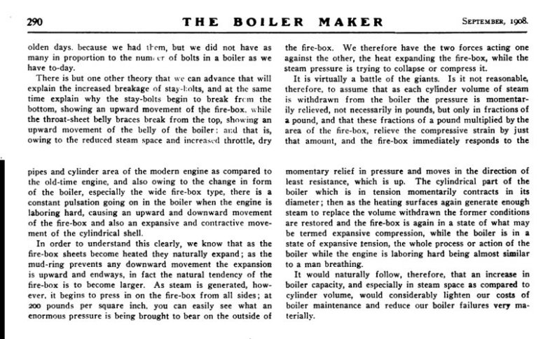

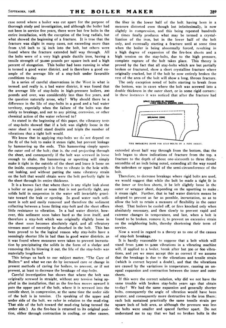

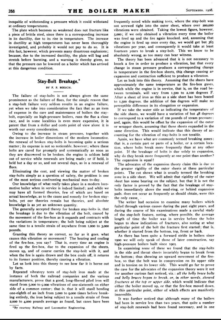

Nothing new under the sun.......

Matt: Yes, in 1908, many thought it was firebox expansion breaking the staybolts but could not explain why the cracks in the staybolts were the wrong way relative to stress in that direction. The more complicated explanation advocated is certainly interesting and reason to have a high margin of design.

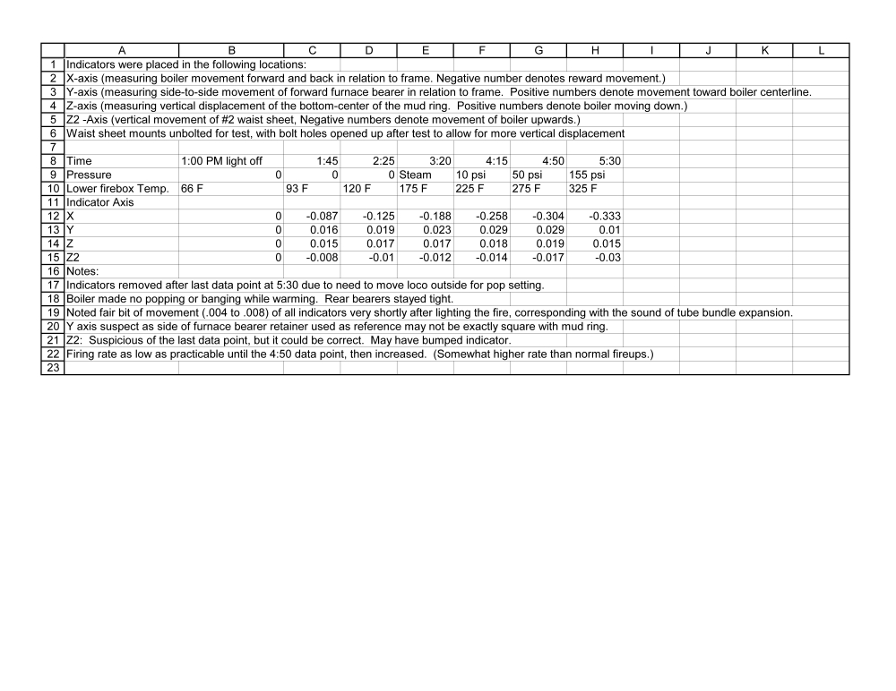

I'll add a couple of things for everyone's consideration. The new boiler for Monticello Railway Museum's Southern RY 2-8-0 was built in St. Louis, MO, by Continental Fabricators. The boiler was stress relieved as a complete unit in their furnace, which is very similar to that described by Randy on the first page of this thread, except they use it regularly. The furnace recorder for our boiler shows about a 6 1/2 hour warm up from ambient to 1150 degrees, a two hour soak at 1150, then a slow cool down back to ambient.
In regards to boiler/firebox movement, we set up some dial indicators at the front of the firebox to see which way and how much the boiler was moving between stone cold and hot. We put three under the throat sheet, measuring vertical movement of the bottom of the mud ring (A 4" thick plate mud ring), and horizontal movement both front to back and side to side. We also placed an indicator under the rear waist sheet angle to measure vertical displacement at that point. Waist sheet bolts were removed, and the front furnace bearers were removed so the firebox was free to move vertically at that point in either direction. One of the interesting things was how soon movement appeared on all the indicators, very shortly after lighting the fire, and coinciding with the sound of tube bundle expansion. We've also placed an indicator at the rear of the boiler a few times to look at total lengthwise expansion, on which we've seen ranges between 7/16" and 1/2", and this is a small boiler. In the below spreadsheet, the temp. readings were taken with a non-contact infrared thermometer, measuring the same location on the sidesheet, just above the level of the mud ring.
Kent
