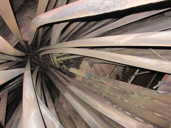

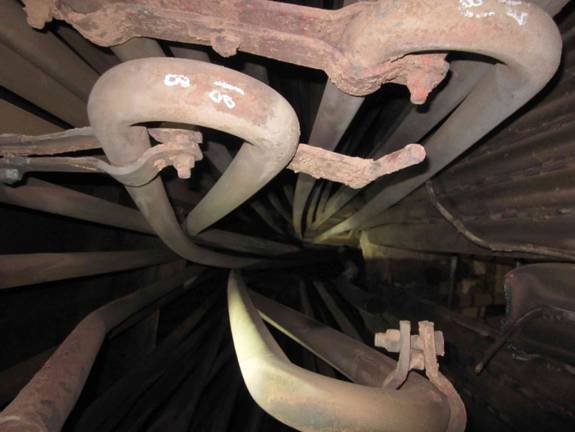

Posts: 488
When steam flow ceases in a superheater, the tube almost instantaneously achieves the temperature of the flue gasses. At the firebox tubesheet at high firing rates the temperatures will be between 1500F to 1700F. For locomotive superheater materials, at temperatures over 850F the carbon will start to migrate out of the grains to the grain boundaries resulting in loss of tensile strength. At about 1100F the degradation is measured in hours.
Powerplant superheaters have a safety valve set to a lower pressure than the drum such that if the turbine trips, it always pops before the drum to maintain flow through the superheater tubes.
Note than my superheater tubes are bent more than Bob Y.'s are......
