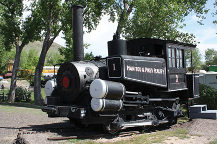

Springing to Hugh's defense (partially), I think he was making reference to the Vulclain system of compounding, with the over/under relationship of the cylinders. Sure, there is still a small amount fo compounding to be found around the world, with mallet type of locomotives and double and triple-expansion marine and stationary engines. But in the context of the Manitou & Pikes Peak Railroad, this is it: the only place will you find an operational Vuylclain compiund--and the other preserved, non-operational Vulclain compounds are confined entirely to Colorado (we have one at the Colorado Railroad Museum).
Mike

"and the other preserved, non-operational Vulclain compounds are confined entirely to Colorado "
H'mmmmm
One in China
http://www.chinasteam.co.uk/trains/pics06/ch06025.jpg
And, there is one in the Yukon too.
http://www.flickr.com/photos/38628255@N ... otostream/

I stand corrected. The first one I remember now as being pulled out of a riverbank or the like a few year ago to be cosmetically restored, and the one in Alaska is new to me.
Let me modify my claim to exclusivity, then, by saying that all of the surviving M&PP Vulclain-compound cog locomotives remain in Colorado. Fair enough?
