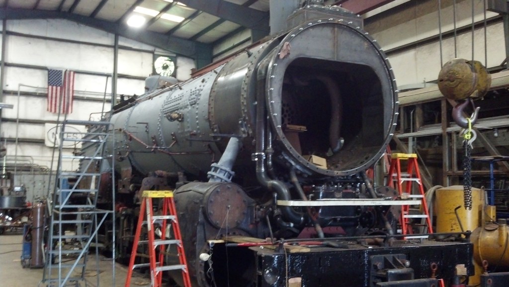

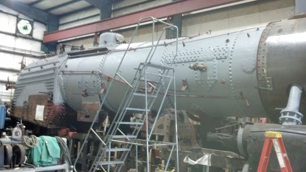

I've attached some pictures that I took yesterday. The application of Thurmalox to the boiler is complete and wedge machining is nearing the halfway point. If all times out right, the wedge machining will finish just as the assembly of the spring rigging and painting of the frame is completed.
The story about 4501's life as revealed from her shop and boiler record will be published when she returns to the rails.

File comment: Thurmalox application complete

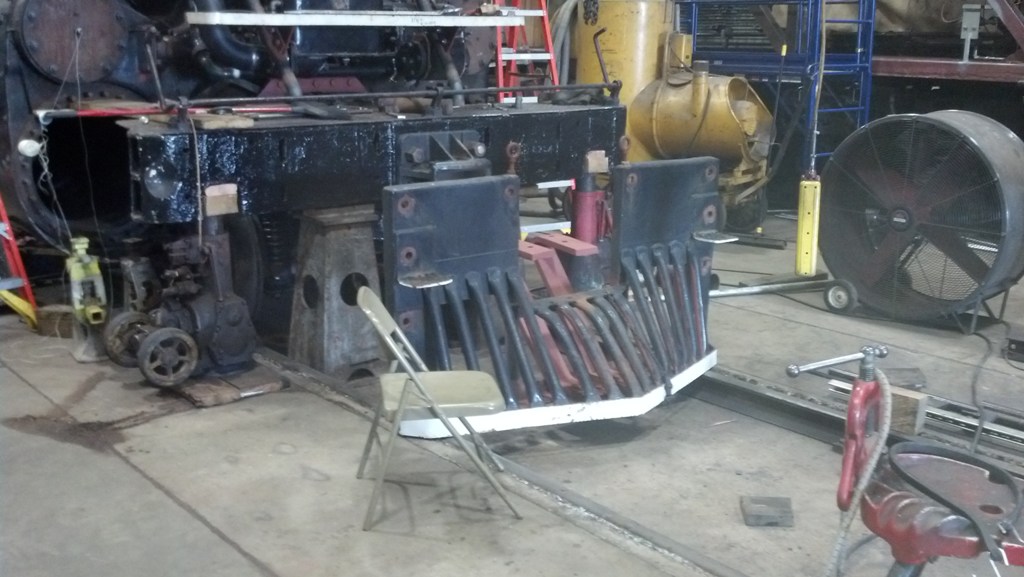

File comment: The pilot awaits bolting to the locomotive
