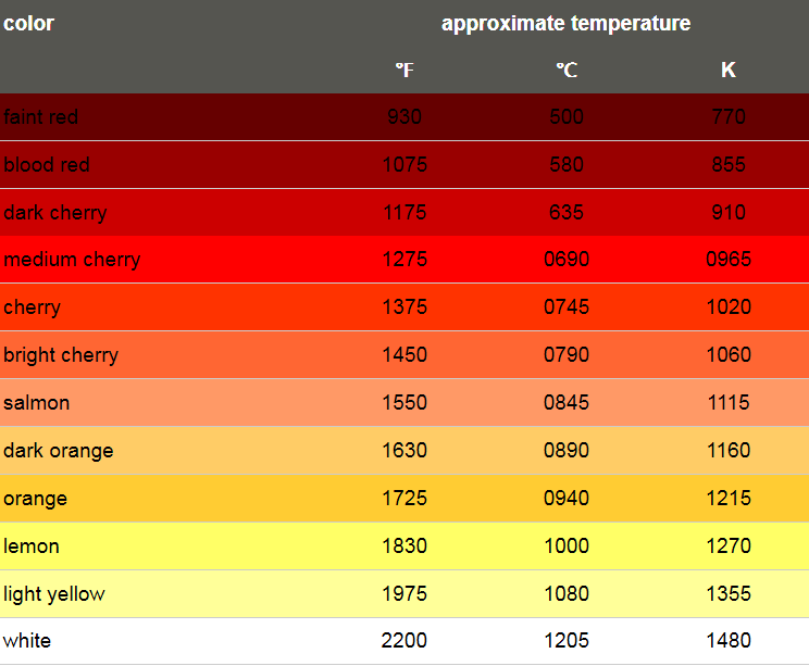

Yes, but NBIC also clearly states that when bolts are heated, critical temperature is not to be exceeded, which is apparent here.
I would not rely on judgement made solely from a photograph. There is no way of knowing the temperature from a photograph unless the photo shows a thermometer or some other device in the same frame.
What happened to the photo, anyway? It seems to be gone.
I see nothing to indicate that a temperature measuring system of some kind was not in use. We have no way of knowing whether or not the person doing the work was using, say, an infrared heat checking device, and laid it down when the proper temp was reached so he could hold the air gun with both hands.

I was under the impression, that based on CFR 49 Part 230.29 (b) (1), FRA did have standards. Do I mis-interpret the regulation?
It reads, (as I'm sure you know):
(b) Repair standards. (1) All defects disclosed by inspection shall be repaired in accordance with accepted industry standards—which may include established railroad practices, or NBIC or API established standards—before the steam locomotive is returned to service. The steam locomotive owner and/or operator shall not return the steam locomotive boiler or appurtenances to service unless they are in good condition and safe and suitable for service.
If this is not established railroad practice, NBIC, or API established practice, then wouldn't it be non-compliant?

You are correct, but this one is kind of self evident.
See attached steel color vs. temp chart. I realize different alloys will vary, but this seems to be a good general guide based on other research. I am also aware of monitor color differences, but they aren't that far off.
