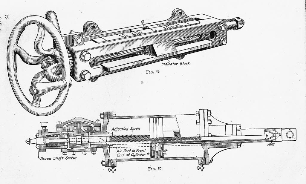

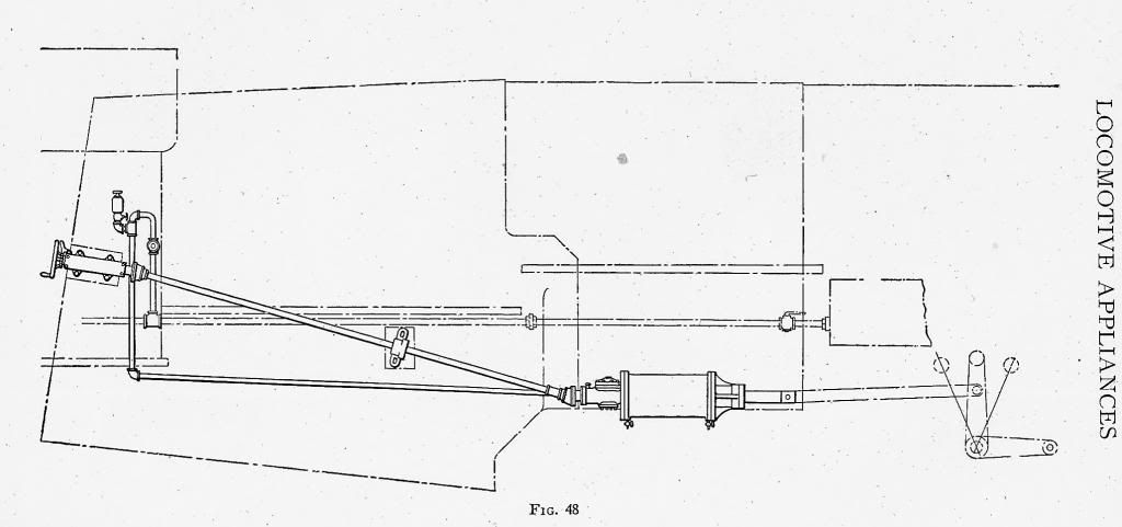

I thought I’d see if I could finally succeed in posting an image without screw-up, and if successful, then try to post the part of an International Textbook Company book published in 1932 and titled “Locomotive Breakdowns and Appliances that describes the Franklin Power Reverse Gear and its operation.
It is a servo system providing a compressed air boost to the engineman’s effort on the screw control handle in the cab.
This is one of four figures in the description.

Now to do the rest of the scanning as I can find the time. I wasn't going to invest the time if I couldn't even get one of the drawings here.
The New York Central had hundreds of these Franklin units in service. As a teenager in the 1940s I hung around the Bergenfield NJ station of the Central's West Shore River Division a lot, and I used to enjoy the loud sound the Franklin reverse gear made when the engineer returned the valve gear to full forward during the station stop, a vey rapid chit-chit-chit-chit sound for a few seconds as the engineer cranked the wheel. My hunch is that during the time the engineer cranked the wheel, the part marked "valve" probably oscillated forward and back a bit, and discharge of exhaust air from the Franklin system was correspondingly intermittent.

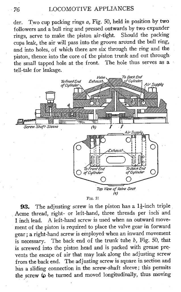

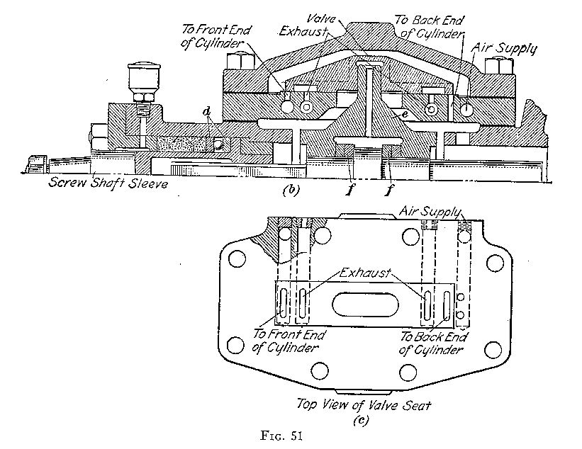

The complete description of the Franklin precision power reverse gear as it appeared in “Locomotive Breakdowns and Appliances” published by the International Textbook Company, Scranton PA, in 1932. Authors of the book were C. A. Cavey of the B. & O. RR. and J. W. Harding of International Correspondence Schools.
Illustrations first, followed by text:
Franklin power reverse gears gave some trouble, witness this paragraph by Brian Reed in his chapter on New York Central Hudsons in “Locomotive Profile,” Vol. 1, p 43 (Doubleday & Co., 1971)
E. W. King, Jr. described similar problems with the Franklin power reverse gear on the Illinois Central (Trains, May, 1984, p 39).
This hunch may be wacko, but I wonder whether the instability might have resulted from a scenario like this:
1) Franklin is aware that that screw reversers suffer a disadvantage, relative to power reverse gears using a lever-and-quadrant cab control, namely, that moving the valve gear an appreciable amount, say from full forward to full reverse, requires more effort and time from the engineer than is required with a lever-and-quadrant type cab control.
2) Franklin tries to minimize the disadvantage by revising the original design, going to an adjusting screw with a larger pitch to reduce the number of turns of the handle required, full forward to full reverse.
3) Step 2 increases the helix angle of the screw, making the screw more prone to turn when the piston pushes against it, thus increasing the chance of instability if reaction forces from the valve gear happen to be just right.
4) Franklin tests the new design on a locomotive, but the valve gear on that engine is a smooth performer and exerts no reaction forces on the Franklin system such as to cause instability. This sets the stage for trouble with the New York Central’s Hudsons and the Illinois Central locomotives, which DO happen, on occasion at least, to exert certain reaction forces on the Franklin system that result in runaway spinning of the control wheel.
