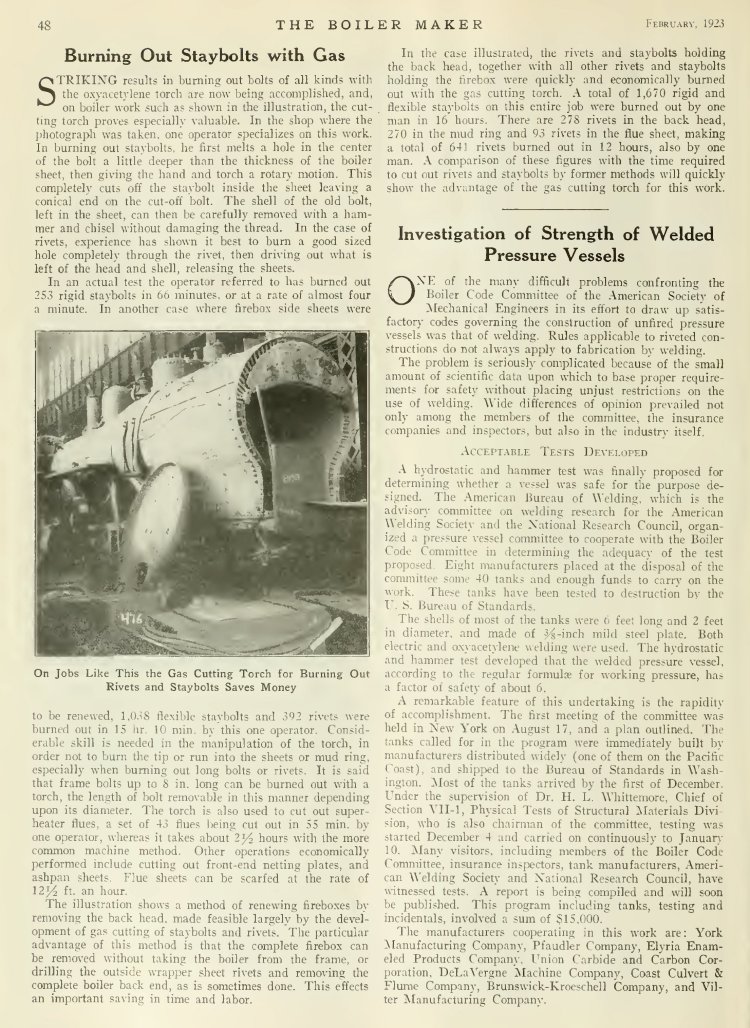

"The way I do it"... If I am in production mode (>25) I have a helper follow me to collapse and knock out the stubs while they are still red hot with a hammer and chisel so I can stay farther away from the threads. Here is the same article from the Boiler Maker in 1923.
