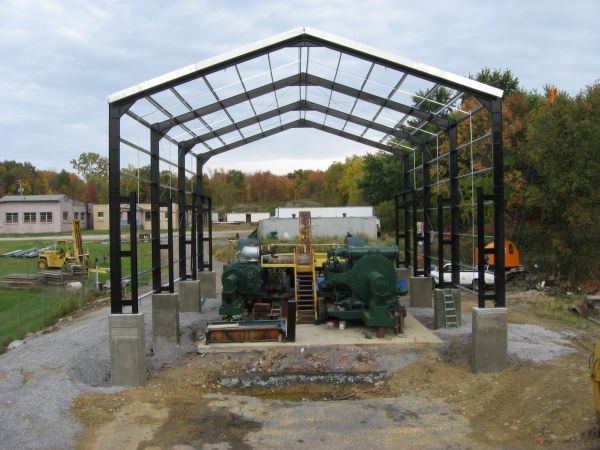

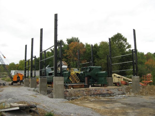

I used an ancient Insley K12 crawler crane to erect our prefabricated steel building at Youngstown Steel Heritage. To get the reach I needed I fabricated a new 20' boom section for it, bringing the total length of boom to 50'.
The big hangup some people have with older cranes is the issue of certification. Not sure that really matters much for an all volunteer force where nobody is an employee. There are many older cranes that are perfectly serviceable but lack all the government permissions to legally operate in a for profit business setting.

Mark,
Thanks. I bought that Insley for $1,200 from a hoarder who had it in the middle of his property and used it to move stuff around. The township got after him to clean up the property and the crane had to go. It was in horrible shape, track pins worn out, so much lost motion that half the clutches wouldn't engage and the hook on it looked like it was hand forged by a blacksmith. But it had a good running Detroit Diesel and looked salvagable.
So I bought it, shipped it to the museum, adjusted the clutches, changed out most of the track pins, repainted it, built the boom section and went from a single part hand made block to a four part block. I wanted a four part block so that I could more finely control hoisting and lowering as it was really built as a dragline and ran fast.
When we poured the concrete piers for the building I used it to place the concrete, using a concrete bucket that I bought on Craigslist. Then when the columns and trusses were erected the K12 really proved its usefulness. After the building had been erected and I no longer had a use for it I placed it for sale, and sold it for $2,500. I basically took what would have been an expense, turned it into a source of revenue and had a lot of fun in the process working on a rather interesting old machine.
I have never had a lot of money to work with on the Youngstown Steel Heritage project, so I've had to come up with inventive solutions to problems. Sometimes my solutions are at best unconventional, but we get the job done.
