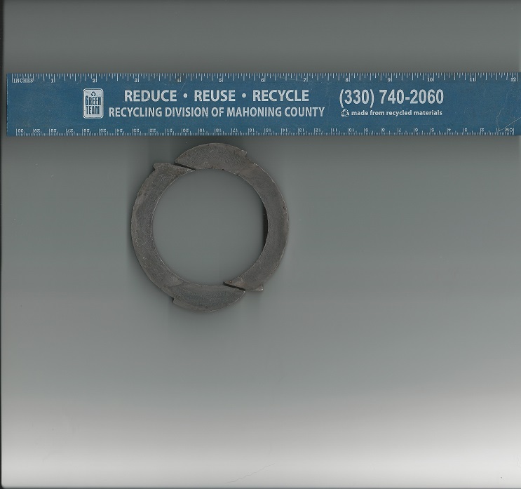

The plan thus far is to water jet a piece of 5/8" plate with an opening corresponding to the shape of the outside of two segments, with allowances given for 3% shrinkage and for the width of a saw kerf to cut the segments after boring. I will cast it solid then bore it out to the finished size then cut into two pieces. I will also have the plate cut into two halves to facilitate removal of the casting from the mold.
That is my approach to solving the problem. Advice and suggestions are appreciated.

The segmented packing is not bronze nor babbit originally. The babbit may be some shops answer to packing however these segmented parts were/are leaded copper. That is why when you clean and look at the piece it looks like copper. When making these pieces the end cuts are very specific so that they work correctly, that is as the I.D. wears the ends keep an alignment and always seal. When these pieces are made the ends are cut with EDM. I think that Historic Machinery Services Corporation, Robert Yuill has correctly made these pieces in the past. The price is not for the faint of heart though. Robert frandsen of steam services of America has success in adapting modern packing to locomotive cylinders.

When getting Southern 401 ready for service at Monticello, we had new old stock King packing we purchased from J. David Conrad for the piston rods and valve rods, as well as the old material. We took small bits of both to the University of Illinois's Materials Research Lab to determine what, specifically, it was. We did this to confirm the material so we could make our own down the road.
This was the Lab's response:
We performed the analysis of the Babbitt material from 401. It is (in atomic percent) ~ 12% antimony (Sb) in a matrix of ~ 88 % lead (Pb). No other elements show up in significant quantity, but must of course be present as trace impurities. From the metallurgical phase diagram, the above composition is right at the eutectic point, so upon cooling below 251 deg. C the liquid will neatly separate into small grains of almost pure Sb in a matrix of almost pure Pb. We found just that in area scans of the composition. Thus, it has the usual design approach for babbit metals: hard grains in a ductile matrix.
This was for both the new old stock King packing, and the old stuff we removed from the loco. Of course, this is a slide valve soak, so I would expect superheat locos to have, as Russ noted, a material with more copper/bronze in it.
Here is the Lab's informal report:
401 babbitt analysis.pdf [485.25 KiB]
Downloaded 657 times
Kent McClure
