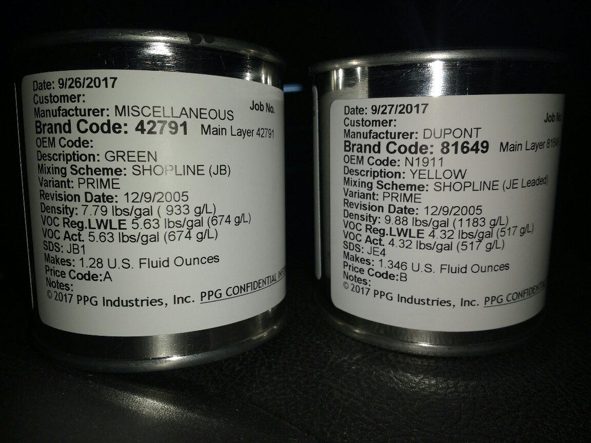

I got it.
The name Ditzler turn the light on...dimly... after Sherwin Williams came back with the same formula as Lowes and Menards and PPG paint store said we don't do that kind of paint, I went to an auto paint store where they mixed me up a sample.
42791 is the correct match for the green
81649 looks to be the gold lettering
Thanks everyone.

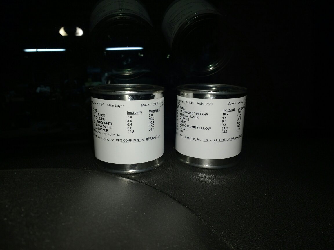

Dennis,
Here's the label info off the samples.
Bill

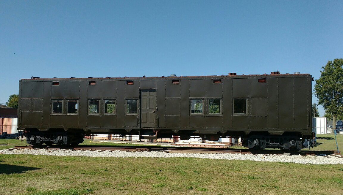

A little darker.
Bill

 Post subject: Re: Pullman troop sleeper color test
PostPosted: Mon Oct 23, 2017 8:45 am
Posts: 534
Location: Danbury, CT
The second attempt looks pretty good to me.
Randy Patterson
RMNE/NAUG
PostPosted: Mon Oct 23, 2017 9:53 am
Posts: 2068
I'd agree. The first version looked more like a weathered color. This looks much closer to what fresh Pullman green should look like. Sure would be nice if there was a drift card to compare it to.

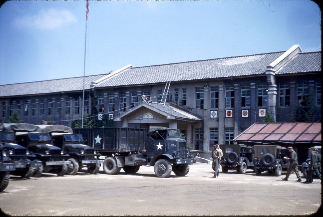

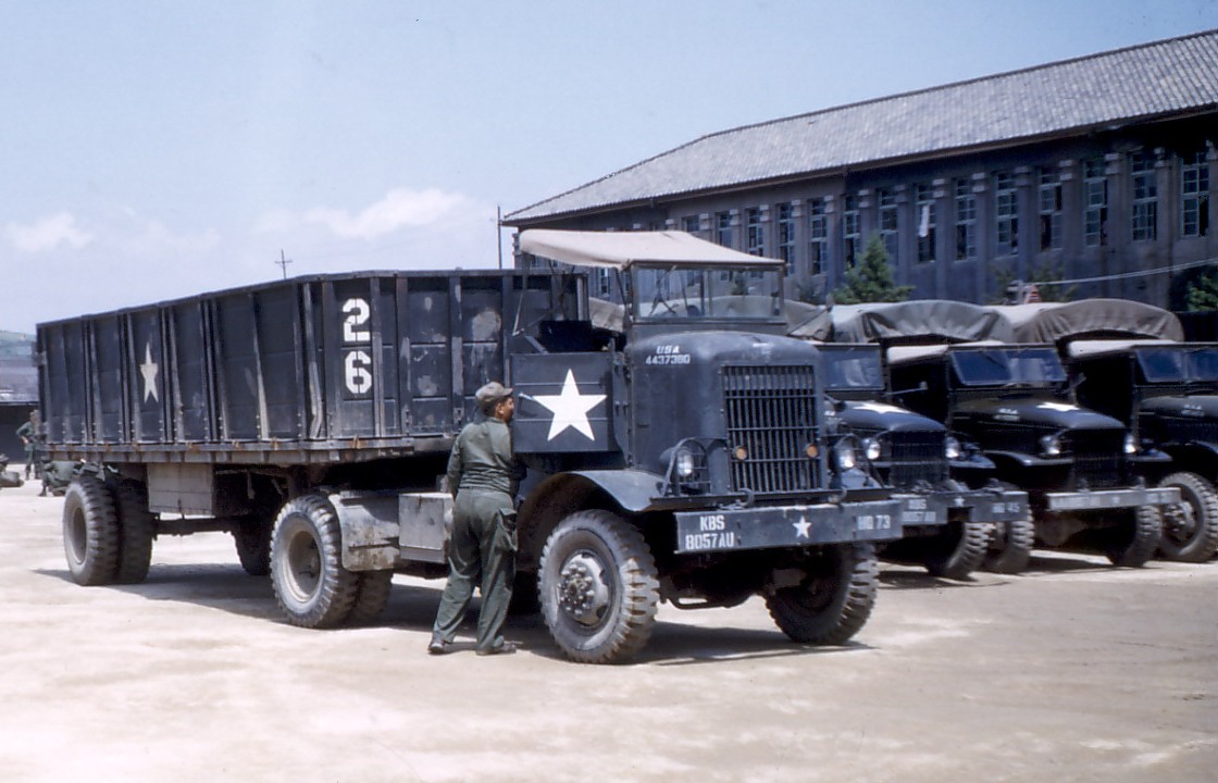

This thread is particularly interesting to me because it’s discussing a piece of railroad equipment
constructed for use by the military. I don’t know if the rail car in the conversation is of WWII era,
or Korea. (It may help to fill in that blank for those reading the topic.)
One would guess the “green” color from both conflicts would be the same.
Would not a piece of equipment constructed for use by the military have to adhere to a military specification
and not the whim of the manufacturer?
[CREEPING DEATH] replied to this thread back on September, 28th:
“I don't recall the source off hand, but I recall reading once that 'Pullman Green' was the exact same as 'Olive Drab' as used during WWII.”
I would agree with CD’s comment above.
The attached photos were taken in 1953 near the end of the Korean War. A couple of the vehicles
positioned between the faded trucks with trailers appear to have a very similar color to the second painting test of the rail car.
(Granted, a color slide taken 64 years ago is open to discrepancies.)
Military paint specifications must exist somewhere and those too, could be a potential source for what color
the car may have actually been painted when it was first delivered to the customer.
John
