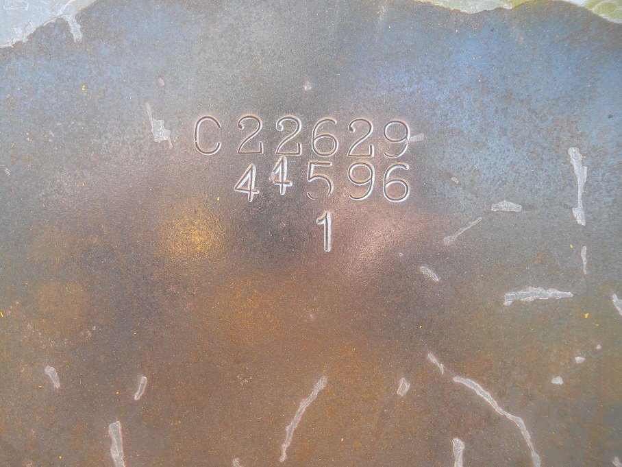

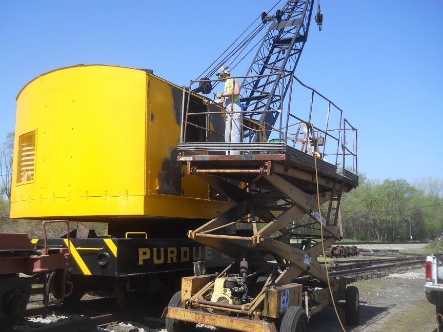

Since the weather seems to have turned for the better, Mark has been working on the Purdue crane and I thought I would post an update. The first shot below, shows Mark using an air compressor to remove any loose paint/primer that is still on the bad side of the crane. Mark also discovered that since the original Orton paint and primer came off this past winter, a number of codes impressed into various steel panels have been exposed. A close up of one of the panels is shown in the second shot. Note the Orton builders number 44596. Finally, a shot taken at the end of the day showing the primer that was applied. Yellow finish coat coming up!

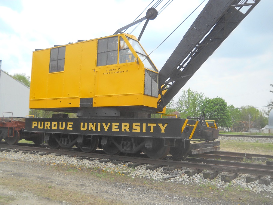

Mark put the finishing coat on the Purdue crane this week!
